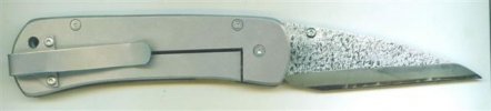

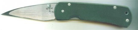

I picked this folding Kiridashi Kogatana up at the Japan Woodworker some time ago for just over $20 and some change on a special they had. Its a great blade but the folder was just too long for convenient carry in the pocket, didn't have a pocket clip or thumb stud opening device of anykind for one hand operation and simply wouldn't stay closed reliably enough for me to justify carrying it, especially with a blade this sharp! For these reasons it sat in my safe and was only used on rare occasions for some gardening work and trimming jobs for projects I had going on.
The blade is a super nice traditional hammer forged two layer steel with a hard very sharp edge at 64 Rc forge welded to a spine of softer tougher iron. The bevel on it is right hand. They also offer a left hand bevel for a few more bucks. I believe the usual cost of this knife is $30 plus shipping.
In the original form it was 9.75" OAL when open. It had a 3.75" blade and was 5.5" closed. (see far right picture of before)
In the new body I have shortened the blade to 3" and the folder is 4.5" closed and 7.5" overall. The lock side is .125 titanium and the non lock side is .125 turquoise canvas Micarta. I bead blasted the entire surface and of course I added one of my signiture low rider clips to it, which I also bead blasted.
It makes a great blade even better for me because now I can carry it conveniently as well as open, use and close it after I'm done all with one hand.
Let me know what you think. I'm really pleased with the end result.

That is nice. It all fits and flows together like it was designed that way from the start. Great work.
Interesting blend of traditional and modern, I think aesthetically a wood inlay in the handle would be worth considering.
-Cliff
Interesting thought Cliff. I'm going to be doing two more of these. I may try something different and use a different handle material on the next ones.
STR
I really like the bend over clip design, it seems more integral to the handle. It might make a good contrast if the clip could be finished to match the flats of the blade.
-Cliff
I assume you mean with hammer marks like it was forged?
The way I make the clips on my frame locks they do double duty as a lock stabalizer also. Once the lock pushes out so far you are pushing on both the clip and the lockwhen you close the blade which adds to the pressure to keep from pushing the leaf lock back too far. The stabalizing effect is not as rock solid as the one on the Striders but it doesn't have to be because I don't cut out my relief for the lock bend as thin as they do. The relief on mine is .065 thick which is well over the .033 to .039 thickness I've measured on the relief areas for the lock bend on the Striders.
