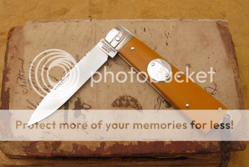

This is a Slim, Slip-Joint Folding Knife with a 2-7/8” flat ground, belt satin-finish blade. Blade and spring are of 3/32” CPM154 steel.
The handle is interesting vintage Ivory Micarta that has aged to a warm, rich colour. Closed length is 4-1/8”” including the lanyard loop. Nickel Silver liners (relieved), pins and file-worked bolsters. The Silver Escutcheon made from an 18th century Spanish 1/2 Real coin. Spine of blade with thumb grooves and geometric file-work.

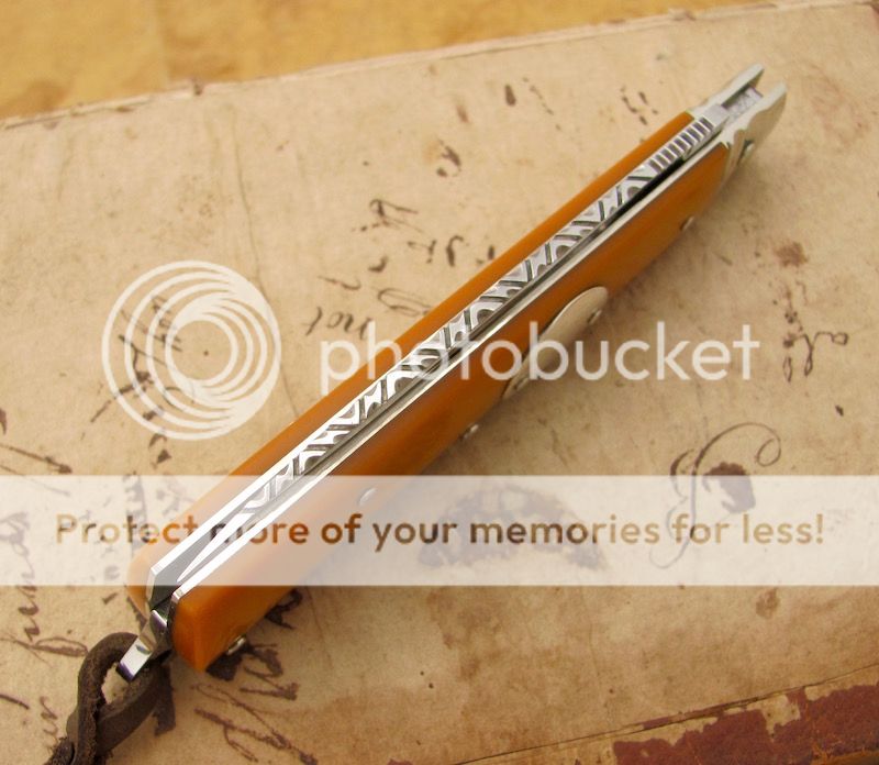

This knife is “under-bladed” meaning that in the open position, the spine of the blade is just slightly lower than the top surface of the backspring**. This is an intentional design element that is often seen in old Sheffield knives. Without this feature, over time, as a knife is used, the blade will want to “climb up” over the back spring. The last photo shows the under blading clearly. The backspring itself is flush with the liners in the open and closed positions. There is no half-stop. The knife opens with a medium-easy pull. Supplied shaving sharp.

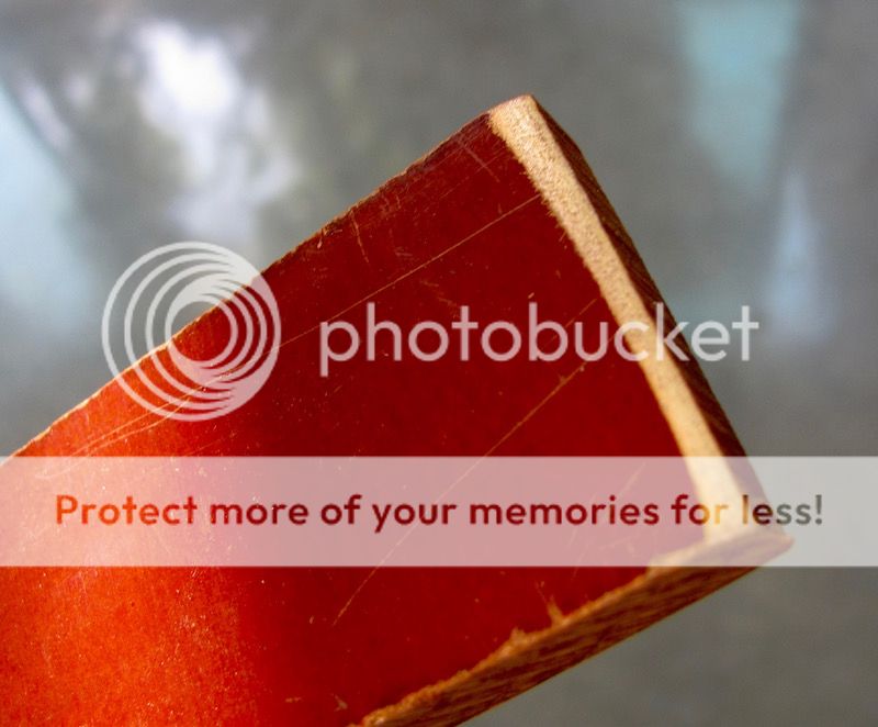

Here's a photo of the strip of Micarta. You can see how dark the surfaces have become. I bought it in the late 70's from Angus-Campbell in California. It's where Loveless was buying at the time.
Thanks for posting the pic of the Micarta slab. Neat to see the aging. Very much looking forward to this one arriving.

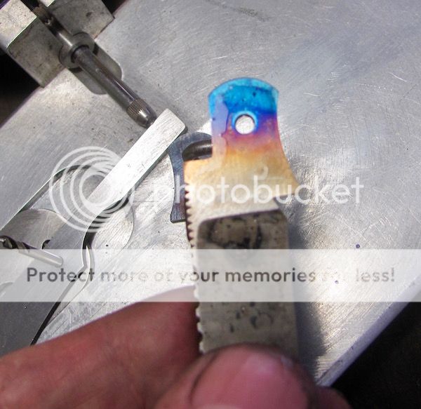

Yes, the uneven hardness of the tang and the spring are of concern to me. From my reading and from watching some of the old films of Sheffield knifemakers, I gather the tangs weren't even hardened. Some that I've tested have been in the mid 40 RC range. It probably made fit up easier and helped equal out the wear of tang and spring.
I've adapted the technique to the steels and heat treat methods we use today. After the blades are hardened and tempered, I clamp them between two aluminium plates with just the tang exposed, and with a hot torch, heat the tang and up into the back square. The plates keep the heat from moving down the blade. See the photo below.
I do it a couple of times, quenching between heats. The short "soak" time is more effective on the simpler carbon steels, however, the stainless steels still loose hardness, although I'm not sure how deep the effect is. Even if it's only a few thousandths, it serves the purpose of bringing the two wearing surfaces closer in hardness.
