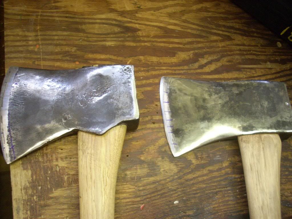

Has offset ridges in eye,no markings.Is that a weld line?
Huh... It does seem awful far back to be the temper line. Which I think I can kind of see about 2/3 of the way in from the bit, though that could definitely just be variation in the patina. I'm no blacksmith but it seems like a good surmise to me.
Its a ridge,You can feel it.so I am pretty sure its not a variation in the patina.Thanks
Do you mean in the axe on the left, the vertical line between the eye and where the bit starts to flare out? To me that looks like the edge of an over-coat method steeling (as opposed to the insert method). Square Peg will probably disagree with me on that, and I could certainly be wrong.
Or maybe it's the edge of the weld that formed the eye, if the sucker's really old?
Yes it is.
I did not think it was that old, because of the ridges in the eye. Maybe it is?
Someone suggested maybe it was made during ww2 when steel was in short supply?
I think it's the edge between the 2 steels in the overcoat method too
probably right,Just thought that it was newer?
According to Kauffmann, the two-piece head lasted well into the 20th century. A lot of people probably thought it better than the new-fangled ones, and some makers couldn't afford to change their machinery. I think he says that the overcoat outlasted the insert method.
I think you're on the right track. I bet it's not a weld line and I'll tell you why. I have never seen a weld line come out perfectly straight like that. It has to be a marking from a power hammer left behind by the forging process. Probably a special shaped die used in creating those eye ridges.
It reminds me of a Kelly that we were talking about on these forums a little while back. Think they had it pattented. A pronounced step down well before the bit. I would guess that yours is just worn smooth over the years.
Yeah I was about to respond with the same. Hydraulic hammer marks for sure. I've seen them on GBs and wetterlings on a few occasions. Bit welding was a very rare occurence on production axes
I disagree. Overcoat method was the most common method prior to 1930 or so. It replaced the inserted bit 19th century method. It lowered steel costs, labor costs were cheap then.
