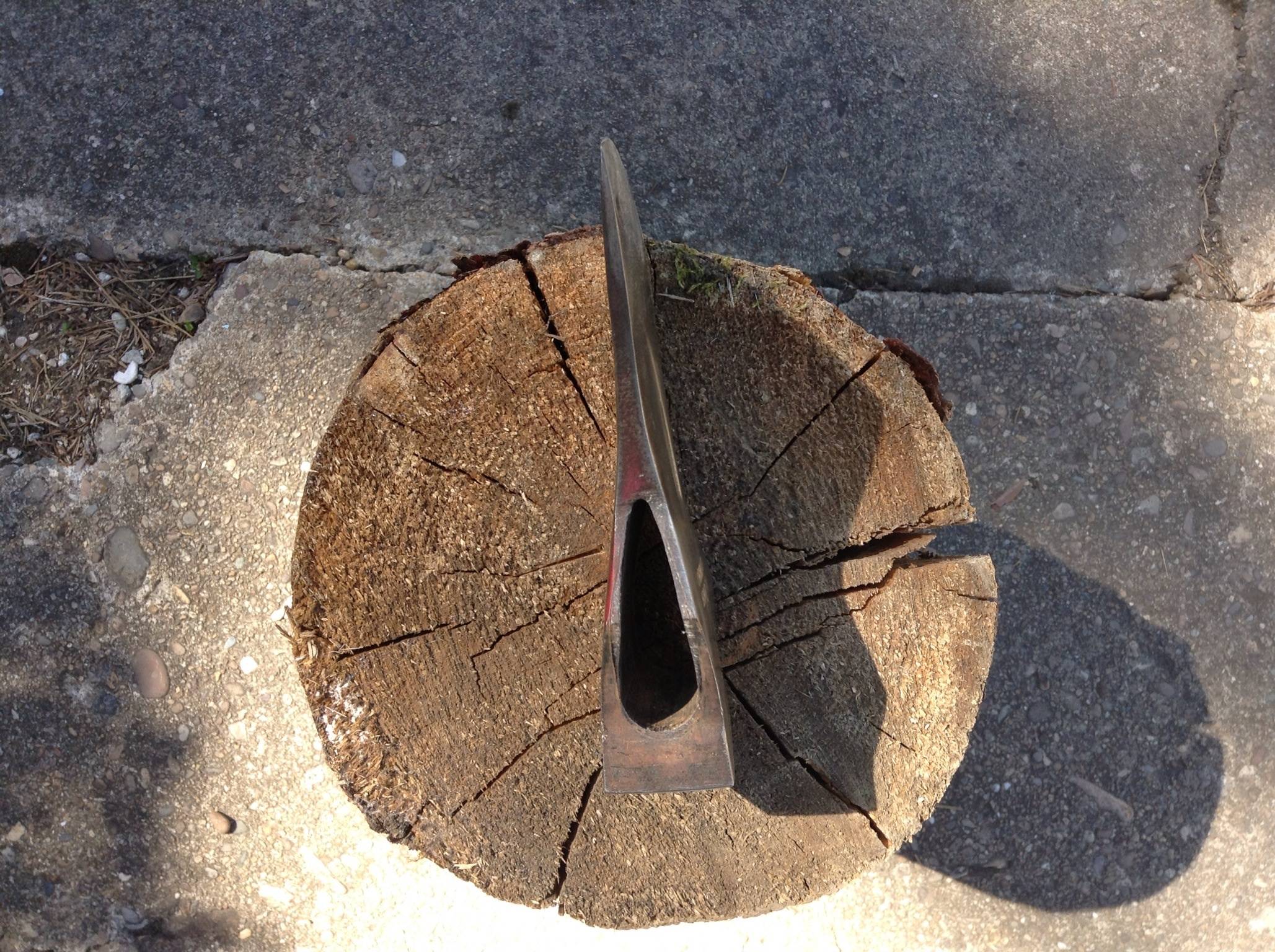

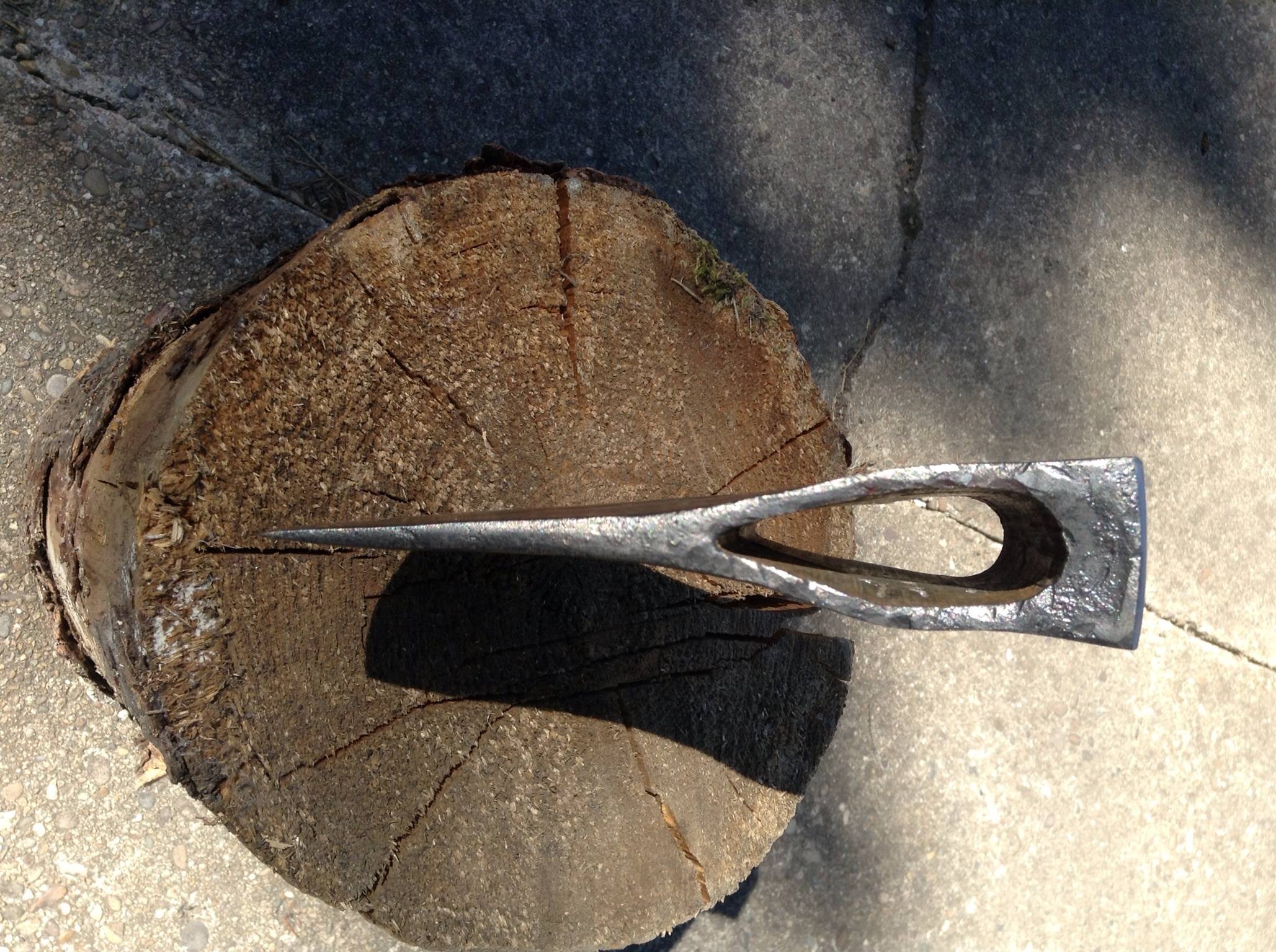

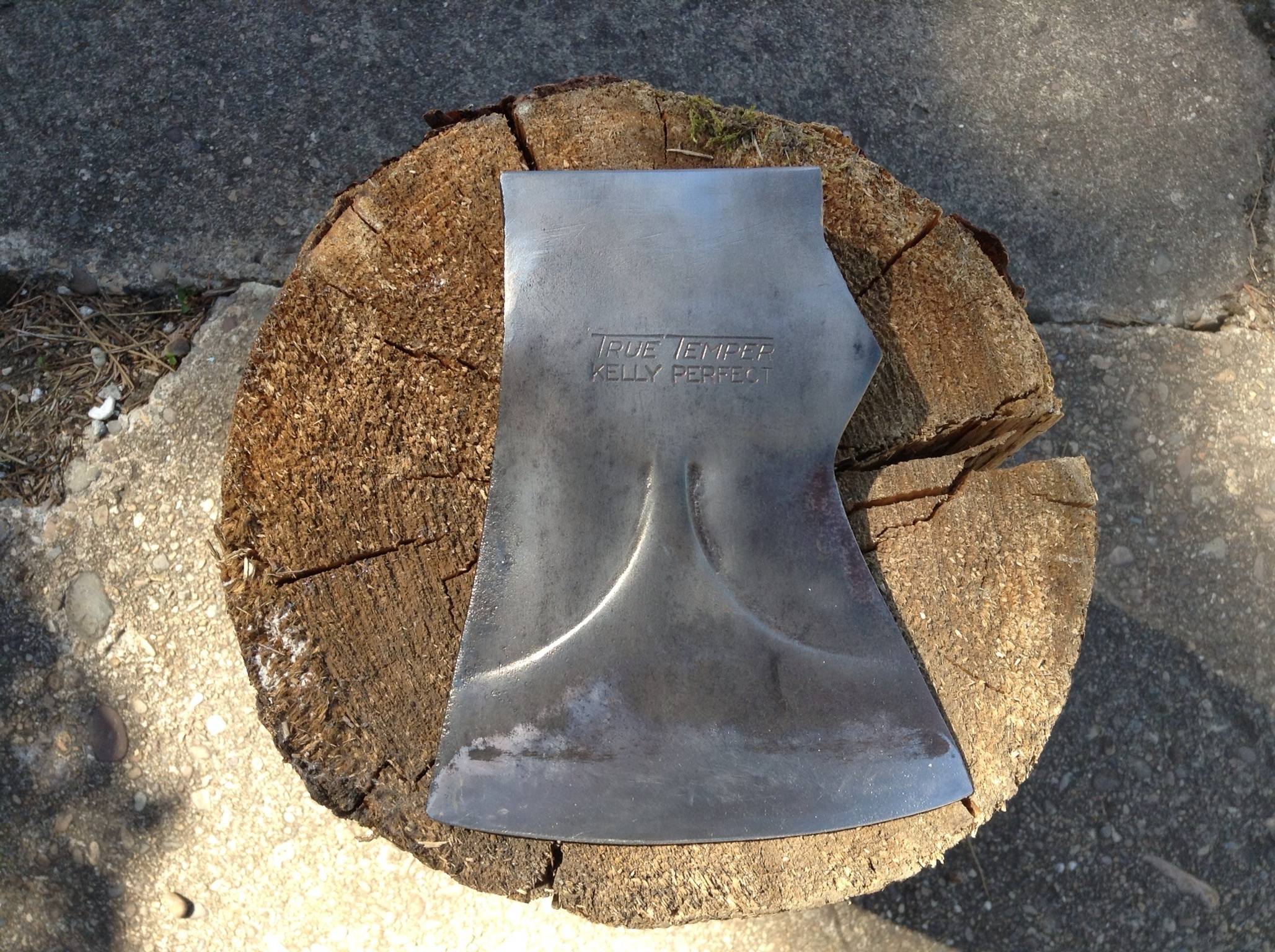

I've got a Kelly Perfect Jersey pattern axe head. I got it cheap but it was in bad shape. It seems that the previous owner(s) used it more to drive wedges than as an axe. The poll was mushroomed 1/4" + on each side, it was painted and was very dull. I spent several hours cleaning it up with an angle grinder, flat bastard and a wire brush. It turned out looking pretty nice but I cant't seem to get it hung properly.
When I try to drive the handle into the head, the handle goes crooked and one side of the head digs into the handle. The eye might be distorted from its use as a maul. Does anybody have suggestions for hanging the axe or am I just stuck with a nice looking paperweight?
See the photos.

Your photos aren't showing up. If the lugs want to dig in, you can file the inside edge of them a little bit so they'll have a greater tendency to slide along the handle. Without seeing the photos though I'm just kind of taking a stab at it. You might have to file out some more inside the eye to get a good profile in there but you ought to be able to see anything that would be a problem visually...

One of the lugs is definitely digging in to the handle. I'll try smoothing the lug inside the eye and see if that helps it slide. I ruined one nice handle trying to force it straight. Chalk one up to experience. If you look at the last photo, you can see some distortion in the eye. Do you think that could be straightened with some judicious hammer work? I thought about heating it a little. I don't think the area around the eye is hardened.
One of the lugs could be throwing the handle off, but as you said, you could also have a seriously deformed/drifted eye. Axe head patterns that are tall (like the Jersey) can appear to have a 'good' eye, but will hang offset.
Also, you're certain the tongue on your haft is straight, right? I was hanging a DB not long ago, only to find out the tongue was the cause of my troubles.
I've tried two different handles. Ruined the expensive one with a crack. Both handles had one of the lugs digging in. Do you think heating the eye to hammer it straight would hurt the head?. It's a nice looking head other than its more than "Jersey Typical" difficult to hang.

Absolutely you can fix that eye with a little hammer work. As a safety precaution wrap a wet rag around the bit to keep it cool. Then heat the flared eye with a torch. You don't need to get it red hot. Remember, it flared out while it was cold. It will hammer back nicely with a little heat. I've re-shaped several eyes this way with no problems. Only heat one side of the eye at a time. The other cold side will offer the resistance needed to shape the hot side.

A picture of the handle alone and a pic of the head on the handle showing the offset would be helpful. I see deformation on the lug but not in the upper part of the eye itself. I often take a spokeshave or block plane to my jersey handles to get the right fit. I find it's easier to adjust the wood than the steel.
