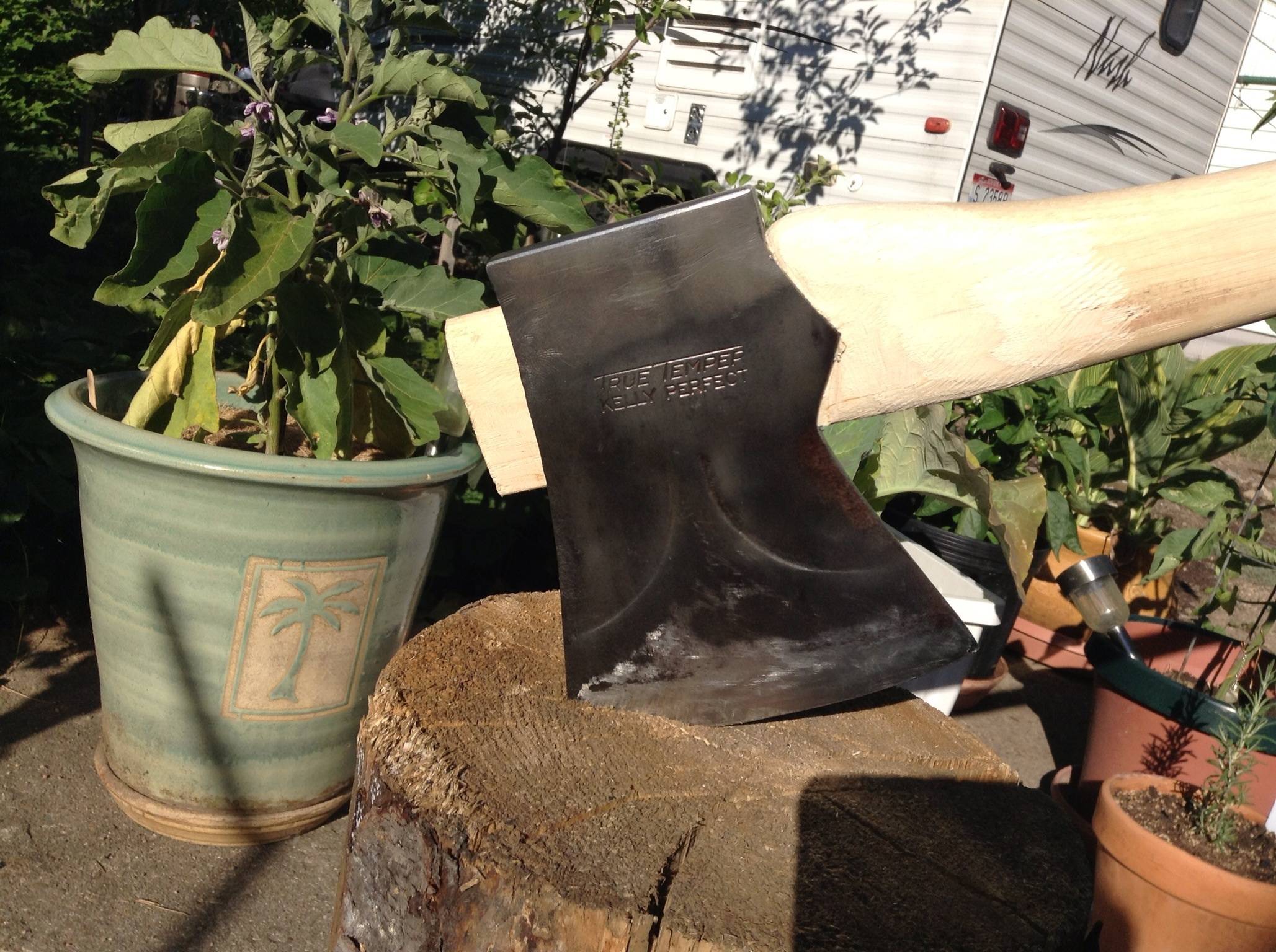

The potato is an idea new to me but it does have merit. I also recommend placing the axe head on a solid stump. Between the one side being unheated and the stump the only adjustment should be where you strike your blows. I regularly use wood in one manner or another to straighten up forge work. Its more forgiving than a hammer or anvil at times and less damaging to the finish. I have a mallet made from a chunck of hickory and it is used often. Go slow and make the adjustment in stages. Its harder to move the steel back out from the center line so go slow. Making small adjustments allows you to sneak up on the final shape without over doing it. Please post your results.

If the lug is digging into the handle, maybe you need to make there be less handle in the problematic area?
This is of course part of the problem. But removing material in the shape of the lug can be difficult. And removing material straight across doesn't look as good. On alternative is to use a coarse grit sanding disc on your angle grinder to carve out a circular area for the lug. It makes for a nice looking hang.

That's excellent advice. I had planned on using an anvil, but using wood would be more forgiving. I'll definitely go slow. I've got a lot of time invested in this axe head. I don't want to end up with a paperweight. I've got a variety of hammers. It's probably best to start light and increase the hammer weight gradually. I'm going to use the potato advice posted previously. I'll also try to smooth out the offending lug. Hopefully I'll be able to post some pictures of large chips cut with this axe soon.

I'm getting there. Got the handle and shoulder roughed to shape. With a little more finish work, I'll be ready to drive the wedge. I'll post more photos when it's done.
That looks pretty good. I might take a little more off of that hump at the poll side of the haft.

I'm kind of looking it over to decide what else needs work. I'll definitely take the rasp to it some more today. Do you use anti-freeze or Swell-Lock to swell the wedge when you drive it home?

No, never anti-freeze. That's propylene glycol, or worse - ethylene glycol. Swell-Lock is dipropylene glycol (DPG). Totally different stuff and non-toxic. Don't ever confuse the two. DPG is used as a base in many perfumes. It's harmless.

Don't the work the same? It's only toxic if you leave puddles of it. I know dogs are attracted to the smell.
I don't know if it works the same or not. Of course you're welcome to experiment with it. I just stick with DPG because that's what's in Swel-Lock and in DAP Wood Swell & Lock.

I'll see if they have any of the Dap product at the local hardware store. I haven't had problems with anti-freeze, on the one axe I used it on, but I haven't had problems with dry wedges either. I think the most important thing is to get the kerf depth correct.
I should be able to find some propylene glycol around here somewhere. Thanks for the advice. No use taking chances.
