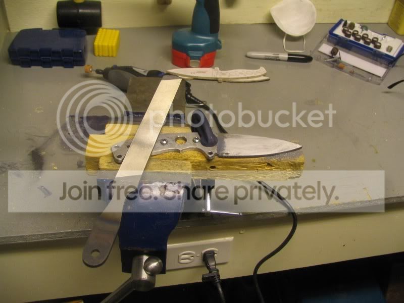

You don't need a "jig". Short of making a knife vise, just C-clamp the tang to a piece of flat bar stock about a foot long and stick the bar stock into a vise.
I used a piece of aluminum t-bar and some leather to protect the blade.Dave:)

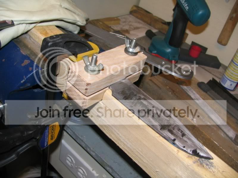

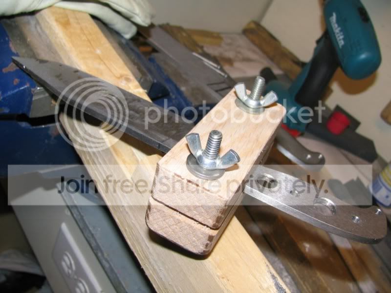

I'll upload a picture of my fancy vice :puke: But for a long time all I used was a piece of 1x2 rock maple with leather glued to the top of it and c-clamped the blade to it. Chucked the wood into a bench vice and there ya go, super fancy cabinet grade rock maple filing jig thingy.
Saftey tip though, make sure the holding fixture extends past the tip of your knife and NEVER EVER EVER leave the blade in the jig and walk off, people will get cut/stabbed/slashed on the "unfinished" knife (ask me how I know.)
OK...here's my second generation jig :D No screws anymore...but I still use my high-tech spruce 2x4...
