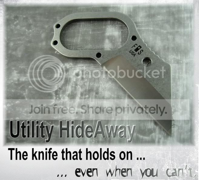

This is my vallor that I was making years and years ago. I'm thinking about making them agian but loosing the little drop leg and just keeping the holes.
What about getting them cast to shape in stainless or titanium? It would raise the materials cost, but would reduce the finishing labor. If it is primarily a SD tool, not intended for much cutting, then titanium with a carbidized edge should hold up OK. And think of the "bling factor" anodizing could add.
It was originated by Hideaway years before Brous.
Chuck
If I'm not mistaken, the Silent Soldier (now SOG snitch) was a copy of another maker on the USN who went by the handle brownmajic. His model was called the snitch, mini-snitch, or some variation of that, though I can't currently find a picture. I don't think they were too prolific at the time that Brous came out withe SS knife.
