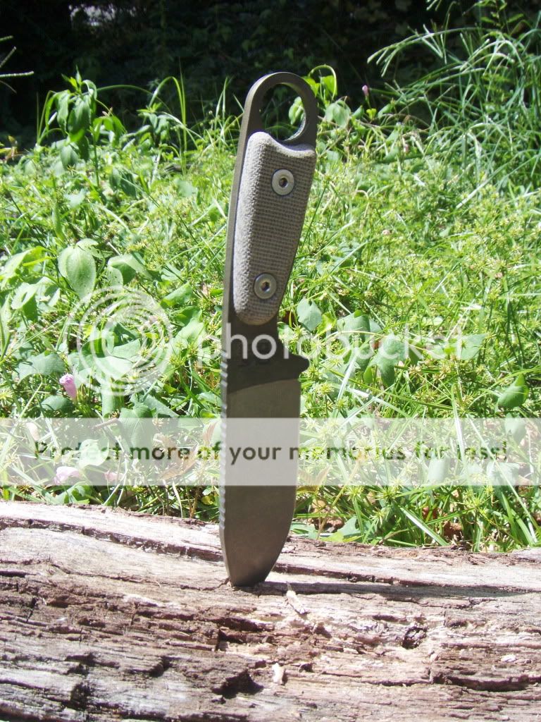

This is what I did to my BK14:
Measure desired spacing with a scale. 1/16" to 1/8".
Mark with fine sharpie.
Cut in desired depth with a half-round file using the edge where the convex and flat portions come together.
Finish with a very small rat-tail (full-round) file.

yesterday I finished the job on my BK-14; first I used a triangular file then I used the rounded file of a dremel, this is the result:
