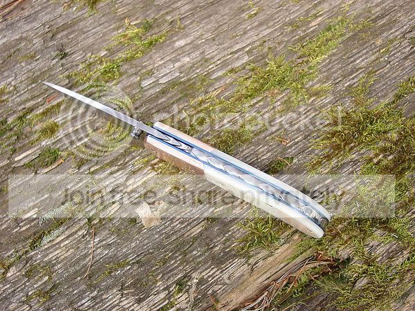

TIP:
When doing file work, the biggest problem is often getting it evenly spaced. I start by laying a ladder pattern of lines along the spine with a sharpie. I make the lines get closer together as they approach the tip ( especially important with a large blade having distal taper). Once the grid is laid, I use the jewelers saw to make the shallow cuts as above. These cuts will be my reference lines when doing the file work. Depending on the pattern, I usually start with a triangle file and make shallow cuts at 45° to the spine, on each side at the reference cuts, all the way down the spine. These cuts are the starting points where I will make curves, notches, line cuts, etc., to create vine and thorn, bramble, barbed wire, vine, arrows, diamonds, etc. patterns. Any left over marks from the saw blade cuts will be sanded out in the final sanding before HT. Using this method, it is very hard to drift off your pattern spacing. The tapered pattern to the tip makes for a very professional look.
I assume you mean something like this, but executed much better?

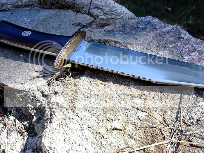

Thanks for the input, guys. I'm talking about the lines at 90* to the blade you put on to keep your finger from slipping when skinning or gutting an animal. I have a Grobet checking file, a Grobet pillaring file, and Grobet knife files, but the jimping still looks pretty rough. Maybe I just need more practice.

In my very limited experience, to do some basic jimping I started by marking 5 or 6 even spaces with a fine tip sharpie. For comfort, I tend to spread them out where the raised flat of the spine between the jimping is as long as the notches are wide. For example if I plan the round valley to be 1/8 inch across, I make my spacing 1/4 inch. I then score each mark with a small triangle file to keep the round file from skidding off course. Then I make shallow round notches with a chainsaw file. I work my way down the spine working each one until they are even.
