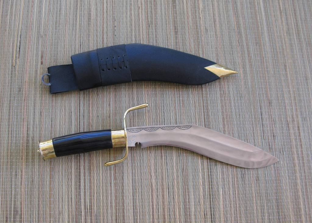

The Jiri model has a large S guard made of brass.
One of my primary reasons for getting this was to see how HI did with the guard.
The guard is solid, with absolutely no rattle. It appears to be very sturdy and I do not hesitate to trust it. The guard arms have smooth oval cross-sections that are comfortable to the hand should they come into contact. The downward pointing arm is a hair closer to the handle than I would like. My knuckles touch it when I am choking up on the knife in my preferred chopping orientation. Fortunately the smoothness of the guard does not make this uncomfortable, but I can imagine some discomfort when chopping hard wood. By backing off down the generously long handle I can maintain my preferred orientation with no contact to the guard.
This gives the user some options. One can choke up in a fencing situation when capitalizing on the defensive features of the guard, and can back off in utility situations like splitting firewood.
The circular disc pommel with conical keeper is similar to, but smaller than those seen on ancient military khukuris. There was no comfort problem with the small disc against the heel of my hand.
The small disc offers less protection to the hand than the larger ones on the old museum khukuris, but I think it is probably considerably more comfortable in utility use. The pommel is of highly polished brass. The dots in this picture are reflections from the dotted countertop.
The cylindrical handle with no central ring caused me a bit of concern. It was in fact quite solid in the grip. It has a swelling in the center of the handle which serves to secure the grip.

For someone thinking of getting a khukuri, but concerned with the lack of a guard as would be found on a bart jam dao or a bowie knife, the Jiri model provides an alternative option worthy of consideration.
