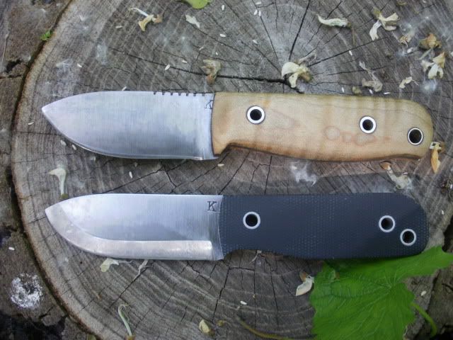

Pack Knife has a 2.75" blade, 6" OAL, 1/8" thick O1 steel and Scandi blade with black canvas micarta.
Ewok has a 2.5 blade blade, 6" OAL, 1/8" thick 1095 and a flat ground with convex edge. It has a maple handle.

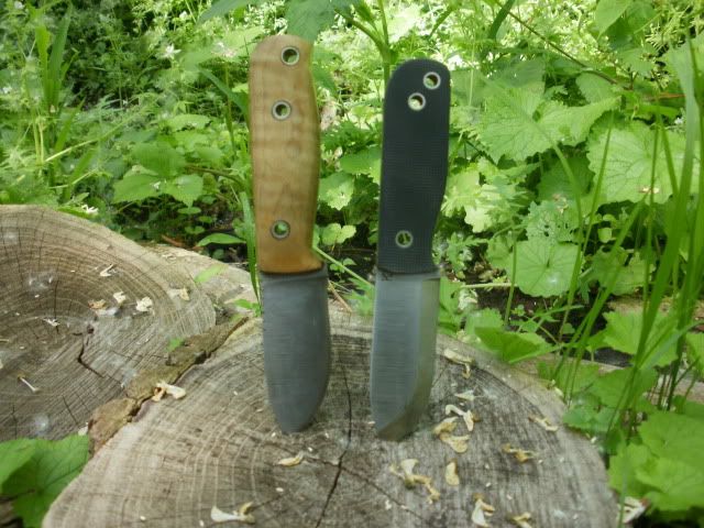

The Pack Knife is small and thin enough to justify it for nearly all EDC type chores. It is even thin enough to use as a neck knife in my opinion. I used this knife for many thing some which were food prep, fire starting, and wood work. The Ewok is similar sized, but nearly twice as thick as later pictures will show.

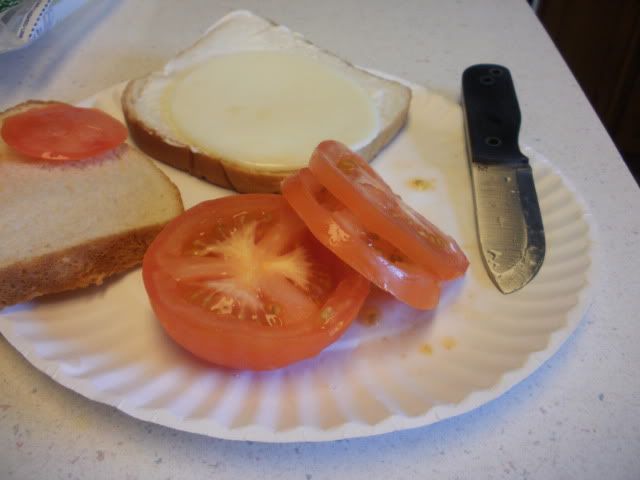

A tomato is one of those foods where a sharp knife is necessary for perfect slices. I didn't have very good tomatoes as they were not as firm inside. They both cut nicely. Ewok was a little better since it was recently sharpened where I didn't touch up the edge on the Pack knife.
Pack Knife
Ewok

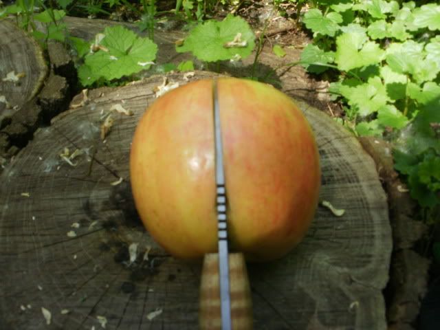

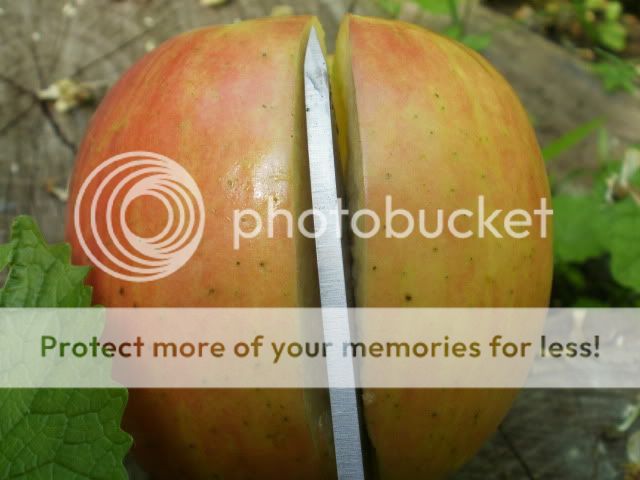

Next test is an apple. This will test the ability to both penetrate into the apple and notching a wedge out. The Pack knife did very well in this since the Scandi grind wedges the slices out very well. The Ewok has some drag since it didn't wedge the apple away from the blade. Also, the Pack knife has a straight edge; the slight recurve of the Ewok can sometimes take a chunk of core if not careful.

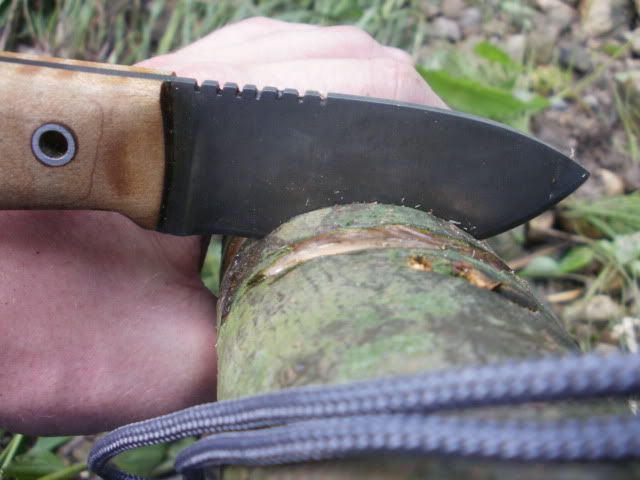

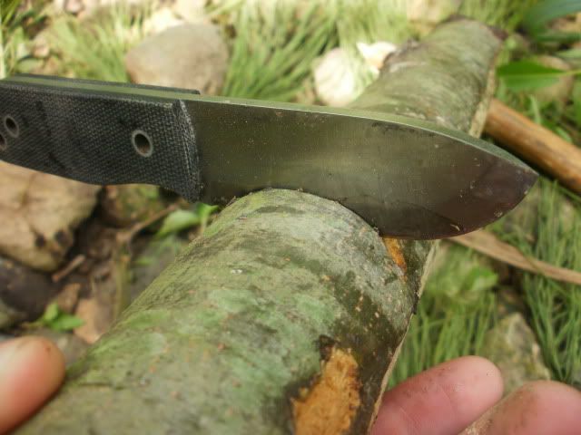

I did some more notching on some wood(I used a baton). It was some Pine that has been drying for months but somehow still very sappy. I was hoping for a little "fatwood" in the center but found none. Both knives did fairly well for the task. The Ewok was definitely more comfortable to use with a baton. The Pack Knife is definitely more comfortable to use with a baton compared to a skeleton knife however.
Pack Knife
Ewok

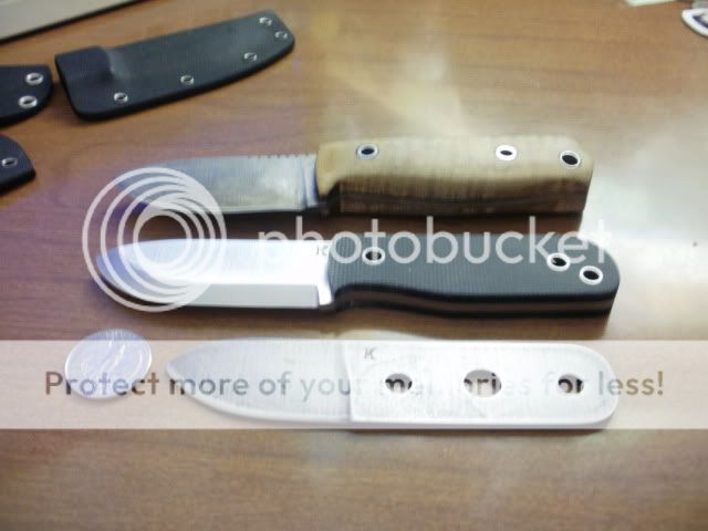

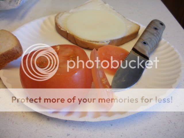

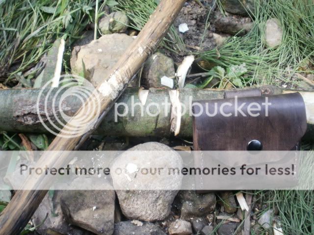

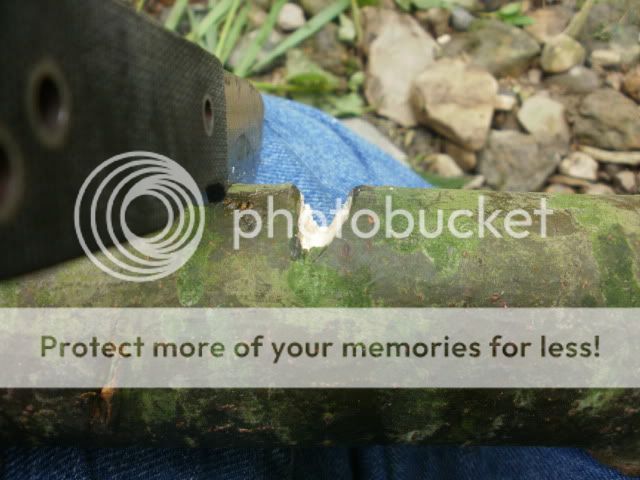

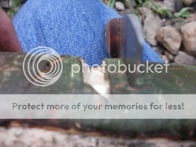

Pack Knife
Ewok

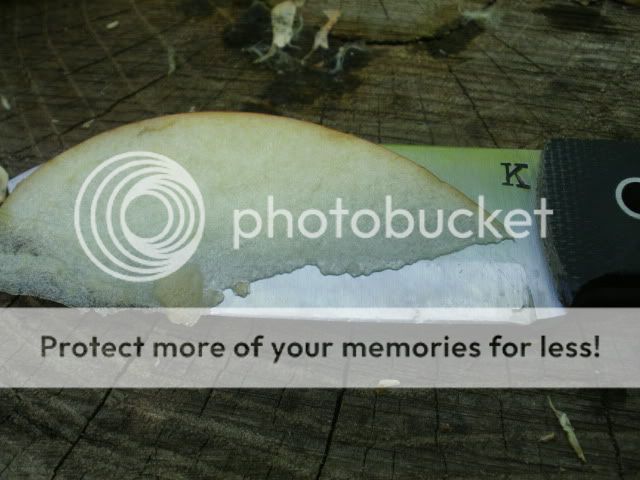

I also created fuzz sticks and the Pack Knife was great at that also. Once you get the correct angle down it makes great fuzz sticks. The Ewok has a better belly to make the fuzz sticks though. Both worked equally well with firesteel/flint. They both can shave magnesium equally. I didn't have camera when doing this.
