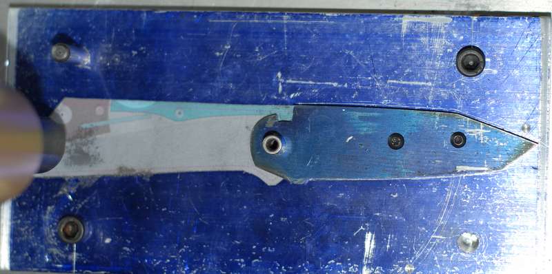

I made a template that I can cut the lock notch on the blade with a perfect finish to boot, it took a little work with a file on the pattern to get the part just right. Not to mention I had forgot how to spot my holes on the work plates but after some more coffee was able to succeed.

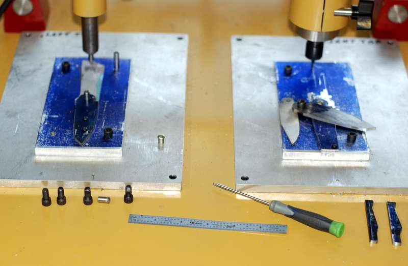

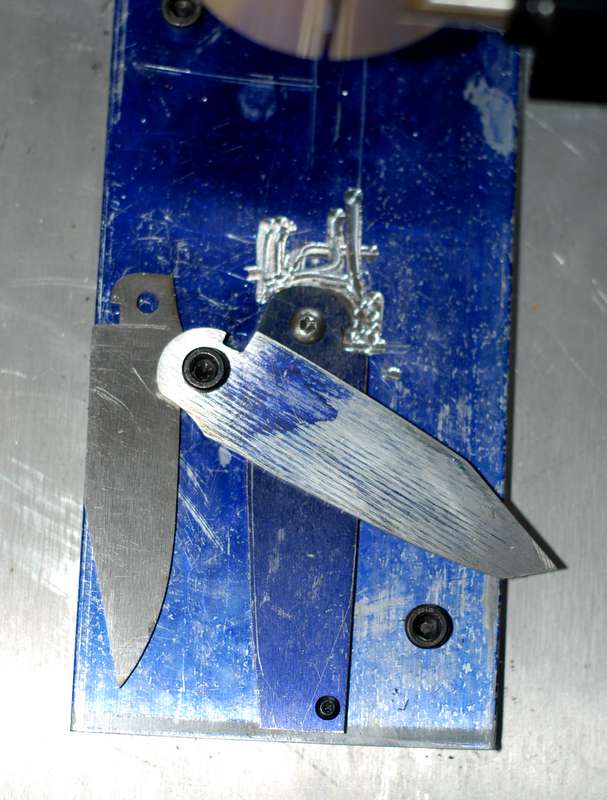

Now I can scribe my lines mark my hole's, drill, cut most of the material out of the notch area grind it close to the line. Place it in the fixture cut the area with the .133 stylus then drop down to the .125 stylus and make a quick zip and I am done with that part of the knife.
I need to have a friend with a good lathe make me some more stylus.

and yes those 2 blade are working as a hold down on the cutting side....I blew the lock area on some other methods for perfecting this step.

The pattern I made today, I am still working and grinding on this one to really nail it down on the part
The first part to cut from it which will get heat treated and become my template. I will give you guys some better pics of the cut area tomorrow, so you can see how good it finish's.

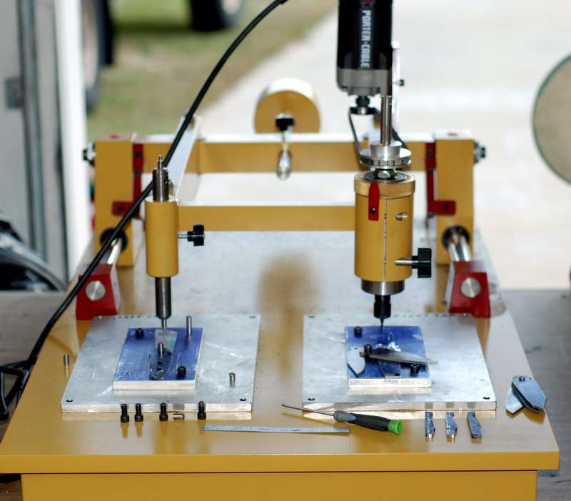

Just a good shot of the work tables
Hey Spencer, Sweet looking little machine :thumbup: About my 2nd year as an apprentice mold maker I was put on a Deckel for about 6 months, roughing out multiple mold cavity for rack & pinion parts. I got pretty good on that old bugger ;) One thing you might find handy will be a cutter grinder and a good supply of 1/16" - 1/4" solid carbide tool blanks. Having the ability to make up your own single fluted tools with whatever nose radius you need on the flute will inevitably save you tons of $$$$ and you'll always have exactly the tool needed for a given job. Sharp ones !! :) Having sharp, free cutting tools on deckel/pana-mill makes a big difference in the ease and outcome of the machining.

For sure there are a lot of little tricks to be learned when using a Deckel. I've forgotten most of them but definitely, IMHO, single fluted solid carbide is the way to go. I'm sure you're already aware of the advantage of using a little bit larger stylus than the cutting tool when roughing. You can really sneak up on tolerance and final finish by choosing the correct stylus size, stylus nose radius in relation to cutting tool size and nose radius. As always, but especially here, sharp tool is rule #1. Rule #2, usually, conventional milling..... unless you have arms and shoulders the size of NickWheelers climb milling can be tricky and costly :rolleyes:
Grinding a single fluted blank is quite easy once you get the hang of it. Of course a diamond wheel is required on your cutter grinder. First you split the diameter to your preferred depth of cut. Next, some guys prefer to create the nose radius prior to adding relief, some guys cut relief first. If you cut relief first on the just split blank you'll have to go back and relieve the radius (if you choose to put one on). For that reason I prefer to generate all of my cutter geometry first, then finish up with the relief. It really is that simple. Like I said, huge cost savings, and always a sharp tool on hand.

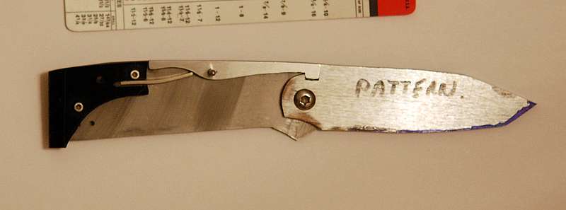

All right I got my pattern done, now I will begin working out the inlay for the design.
Here is the first knife cut from the pattern, its really tight and the repeatability is gonna be good.
First five will start this week, hope to have five at the end of the week:D
This folder stuff is really about paying your dues, if you want stuff working right.

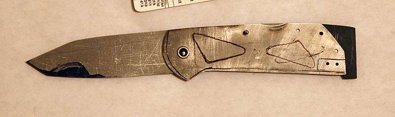

This is the start on my inlay concept
