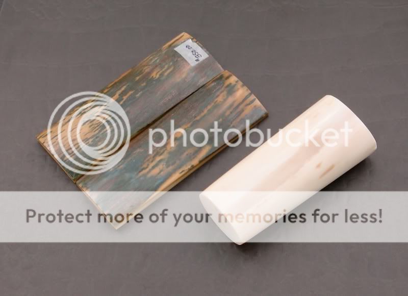

John’s first step in the process is the handle material. These were his choices:
I chose the greenish Mammoth Ivory.

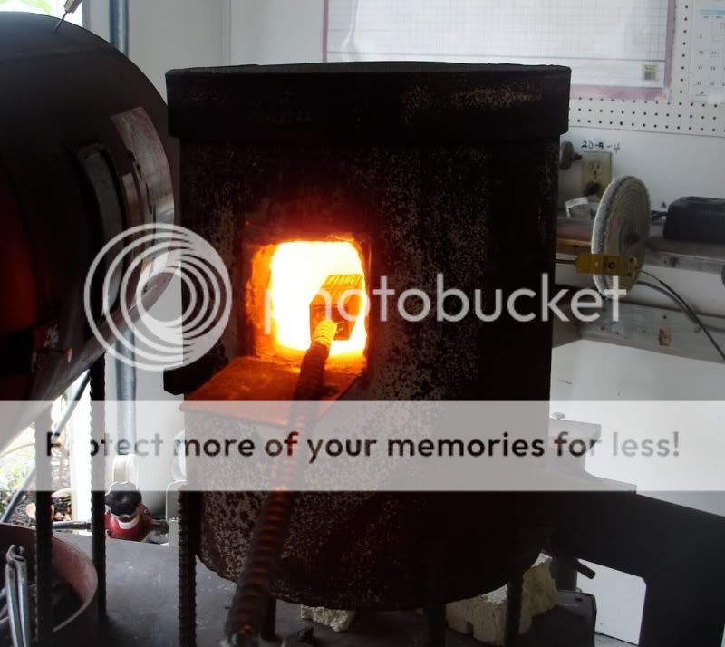

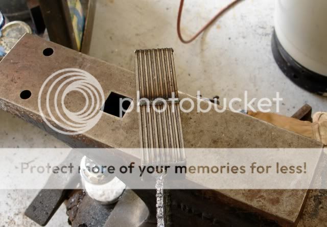

I wanted a Turkish Twist Damascus so John then stacked and tacked up a billet of 17 layers of 1084 & 15N20 for forging:
Then into the forge:
John next welded, drew out and twisted the Damascus:
