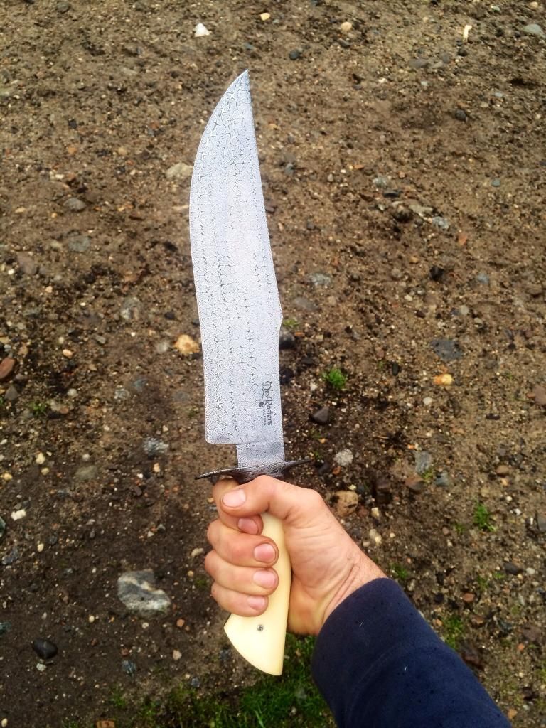

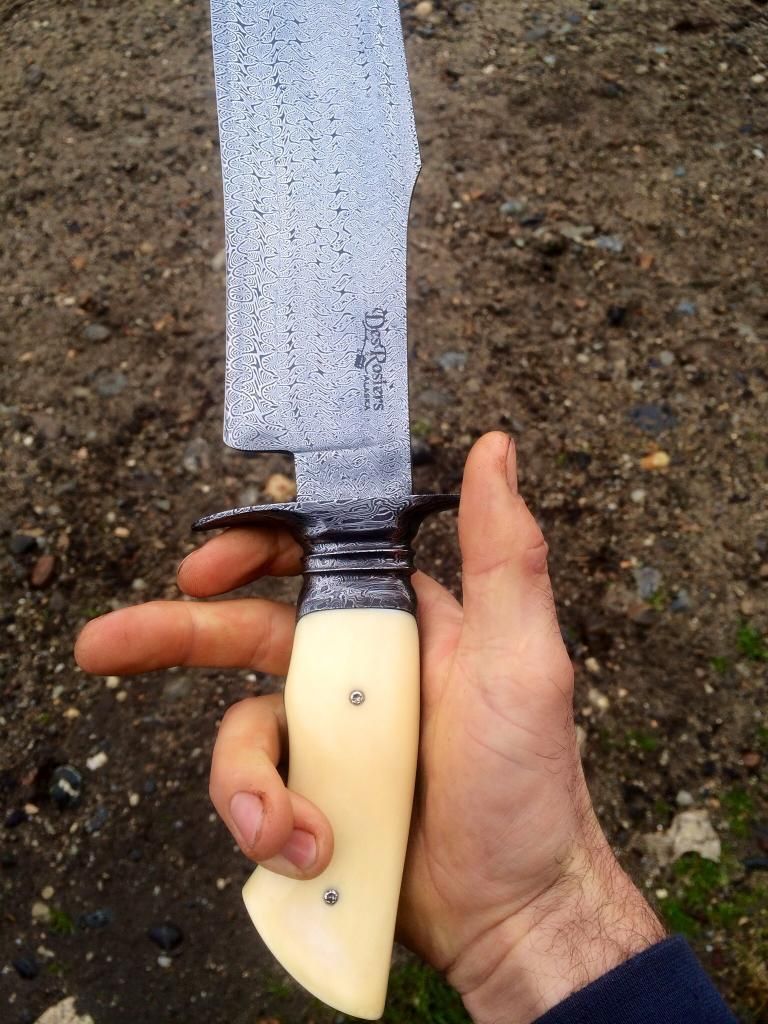

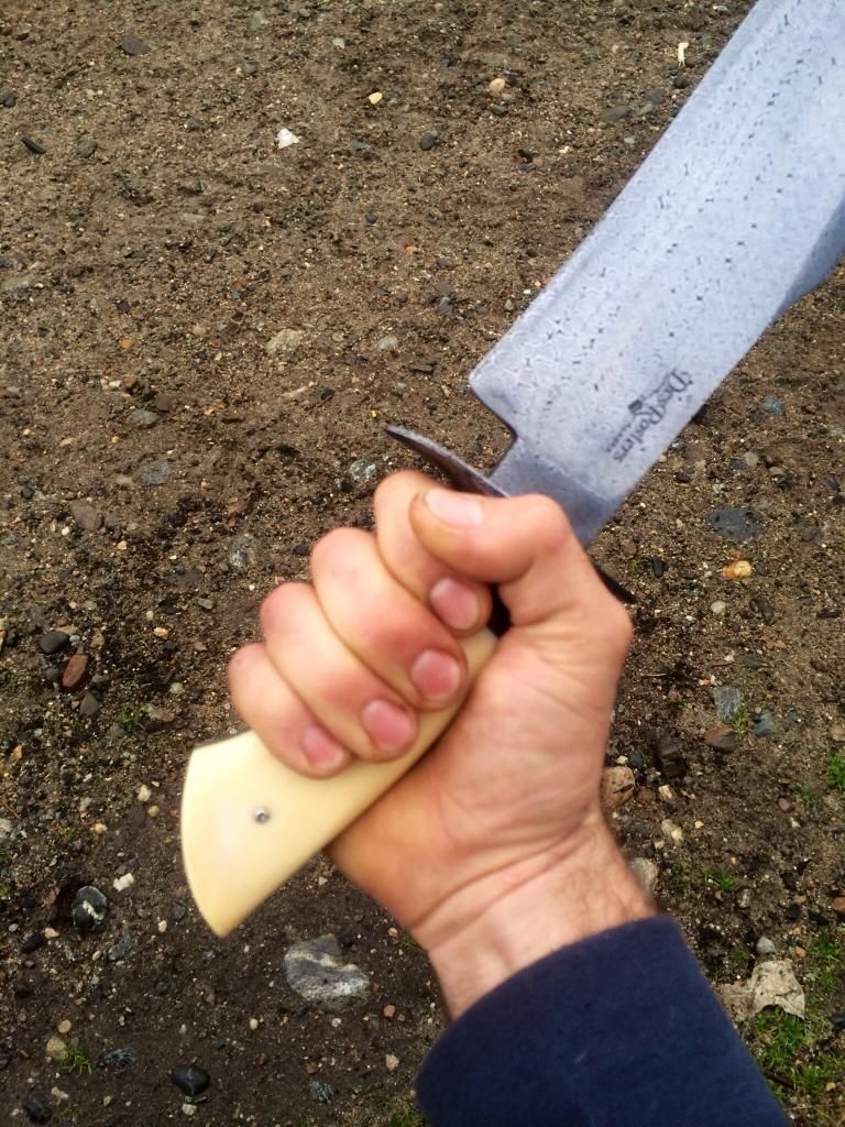

These are interesting comments regarding the handle. It may be just the photograph angles, but aside from the fluting of the bolster, there were no changes to the handle. It is always a hard decision on an integral to choose how much bolster to leave. As many of the comments indicate, the metal bolsters give the illusion of a shorter handle. In the beginning, I had intended to flute the bolster, and it was a last minute decision not to. I used mosaic Damascus for the bolsters rather than the same twist pattern of the blade, and thought to showcase it by leaving it smooth. In the end, the result of the fluting on the bolsters adds better grip and greater control of the knife. Perhaps these snapshots will illustrate the handle proportions better. The handle is 5-1/2", and the blade is 12-1/8", so realistically the handle is almost half the length of the blade, or. 3:1 ratio. Almost the golden mean.

Agreed with Adam... I think the pics were somewhat deceptive making the handle appear shorter when it's proportions are spot on for such a large knife.

Hello Adam, I didn't mean to infer the handle to blade proportions were off, just that the long bolster made them appear to be off. In your photo below where the bolster is covered the handle to blade proportions appear perfect.
Integrals are always a bit tricky to make appear conventionally proportioned right... in actuality many times the bolster itself serves as the front portion of the grip.

Salem hit it right on the head. This is a constant issue we deal with on integrals, or any knife with bolsters of similar material as the blade. Kevin is right, the bolsters always trick your eyes into seeing the handle as too short. Even worse though, are knives where the handle material appears to be the "right" Length, but results in a handle that is awkwardly long to hold. The issue is a two edged sword. The very problem we are discussing is the same feature that makes you instantly recognize a knife as an integral, which is the whole point...
