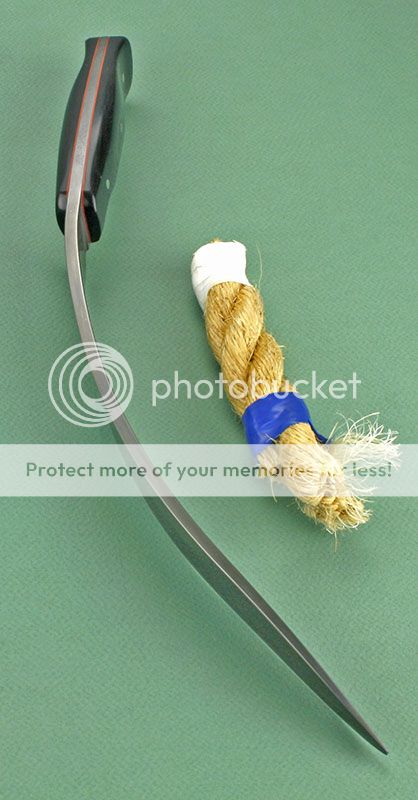

Just passed my journeyman smith test with Shawn Mc Intyre and thought I'd share it with you all. The pine we have here is a lot harder than the stuff you have over there. I dont think I could have got a harder piece if I had tried. Thanks for looking.

Nice even bend.
Congrats!
It always makes me cringe, those bent blades. I understand the principle of proper ht and flex vs break but still...it feels like a waste to me, sorry. Congrats!

Beautiful bend test Keith. That's an example of great heat treat control, with the return to a fair arc.
If it isn't inappropriate to ask in this thread...I'm wondering, wouldn't the execution of a well executed distil taper (and even the profile) play as an important role in achieving such a graduated bend?
