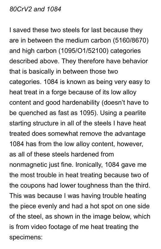

I think I may have just solved a problem that I have, but I didn't know that I had it until heat treating samples.
The dilemma - my samples of O1 and 26c3 matched toughness and hardness curves that larrin published. I've done hundreds of both of these before sending samples (counting old files with 26c3, they are *very* similar both in snapped samples and resultant hardness and feel on he stones.
I think what I just found is that the color of 1084 (thus the temperature) when transitioning to nonmagnetic is lower than O1 and 26c3.
can anyone confirm that? I
think when I assume I"m doing subcritical cycles with 1084, which it probably doesn't gain much from, I'm actually quenching new grains in over and over. I tried that by heating 26c3 and files past critical and quenching each time in a cycle of three - the grain coarsens.
The tail end of what I do with 26c3 is heat it past the recommended furnace temp, but quickly and then quench. this might take 10 or 15 seconds, and I can't see observable grain growth.
With 1084, 10 second more of heating under my small scope even with no thermal cycles doubles the grain size.
I never considered that the color temperature of steel would be that much different when they're all pretty much plain - that is, what they look like when they change to nonmagnetic.
This may also help to solve the problem I mentioned below -wanting something that's in its tempering sweet spot for chisels (harder than knives - people don't complain about chisels that won't bend back and forth, they complain when the edges roll or chip, so the bias is to chase a little more strength than toughness).
I realize this isn't a popular thing - heat treat in forge with no attempt at any duration of temperature soaking, but would guess that there is some historical use of it (not recently) before thermocouples were available. And I've had a lot of 200 year old tools with good toughness and strength balance (think thin somewhat harder slicing knife - something that doesn't hold its burr much when sharpening).

Hi, Devin - actually, I think that someone working by eye is going to have to take what they can get and be satisfied with it. If the result isn't as good as a furnace or it's as good with very limited alloys, then they have to go with it or buy a furnace. I have no financial hurdle with buying a furnace, but I do have a two car garage and setting up yet another table in it (I already do woodworking in the shop) is a space consideration, but there's more underlying here.

Here’s an article from knife steel nerds. Larrin Thomas was experimenting with forge heat treating.
It's less forgiving for someone heat treating in a forge and using good stock. that's for sure. I don't think that will change the narrative but I posted pictures of files (similar to 26c3) in another thread with more overshot in a very quick quench heat, the same as I do with 26c3.
1084 didn't tolerate it at all. 1095 tolerated it better, but not well.
I'm not surprised that larrin had trouble with it. Backtracking and shrinking the grain today as shown above in pictures, I brought back what was done just with about 10 seconds of overheating - something that's never really bothered 26c3 or O1. I shot the samples I sent to larrin of both to the same high temperature after borderline magnetic or submagnetic cycles.
I get what the idea is with 1084 being easy for beginners, but I think asking beginners to have that kind of an idea of going only just past nonmagnetic and quenching when they're going to be all thumbs is a big order.
