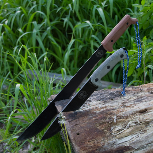

I'm not quite sure what that picture of the chopping is supposed to show; the knife on the right is not an RTAKII.
The picture of the group is misleading as well. The RTAKII is just a bit longer when set side by side in other photos I've seen.

nice pic..
wow !! there is quite a difference, did you use your weak hand with the rtak?:D
FYI that isn't a RTAK in the picture of the two knives on the log....
Looks like a Busse of some sort..... the Junglas can really hold its own, even when compared to knives costing much more. And the sheath is better than most knives at any price. :D
