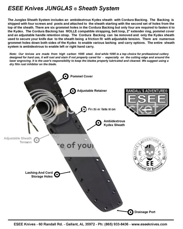

The Junglas is shipping ahead of the printed instruction sheet so here are some temporary tips.
--The cordura top is shipped with and fastened with four screws and posts only starting with the second set of holes from the top of the sheath. There are actually six grommet holes in the cordura top but only four are needed to fasten it together. Don't call me complaining that somebody left screws 5 and 6 out of the package. They were never there
--The cordura top has MOLLE compatible strapping, belt loop, 2" extender ring, jump flap and an adjustable handle retention strap. The Kydex bottom has an additional lock up with adjustable tension. This system complies with the military's requirements for jump safe sheathing.
--The cordura top can be removed from the Kydex sheath which still has a built in lock up with adjustable tensioning screw. There are plenty of grommet holes down bvoth sides of the Kydex to enable carry options of your design.
-- The entire sheath system is amibidextrous to enable left or right hand carry.
