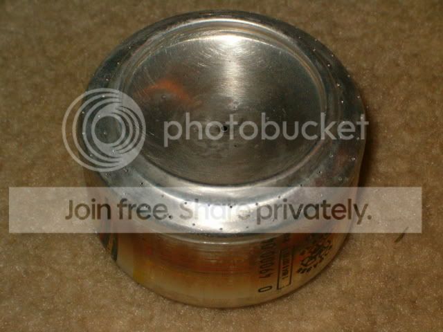

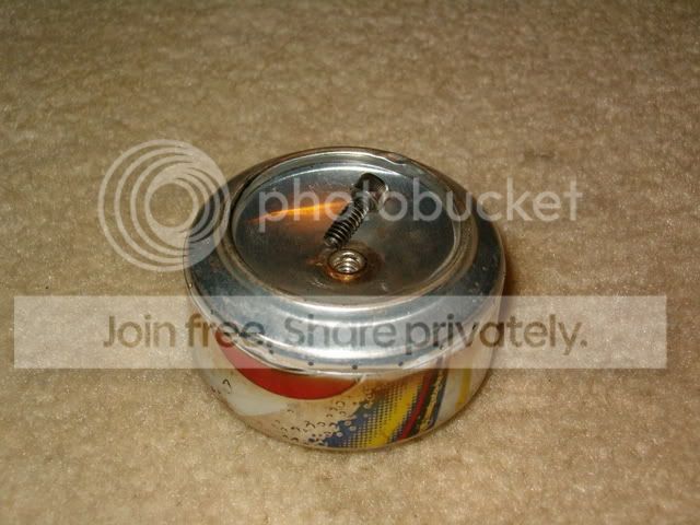

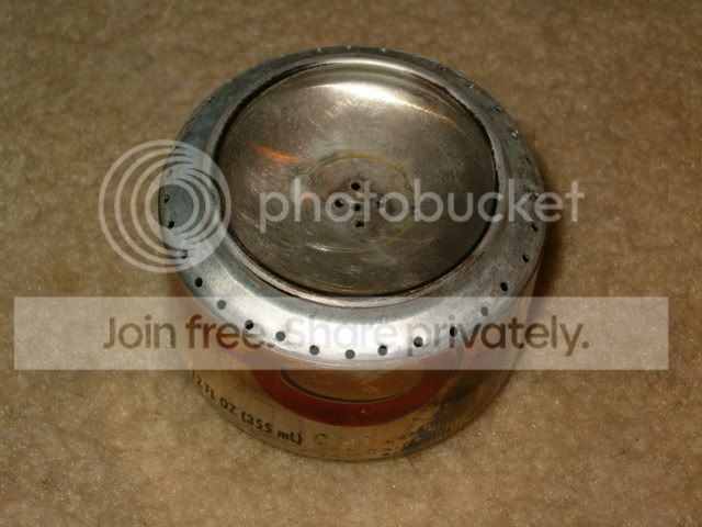

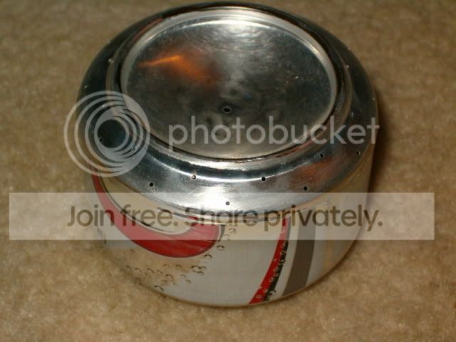

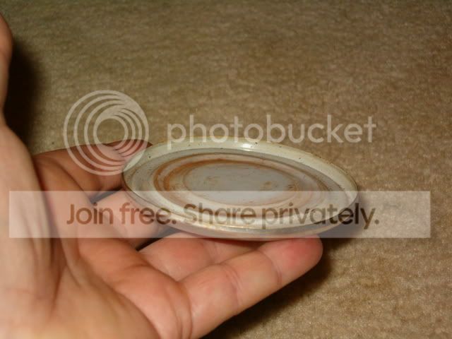

Here are some shots of a few of my pop can stoves, and primer pan. I don't have shots of my spring loaded fuel cap, but may add it later. Basically, I found that numerous tiny holes will outperform, few large holes for burn time, and boil time. A set of micro bits from Harbor Freight was the best thing ever for my home built stoves. And my riveter is nice too. I have never had any function or durability issues with them, of course you can't sit on them, or stack dutch ovens on them, but I have set a pan with 20 oz. of water in it on the stove for a full burn with no ill effects. Fun, and easy to build, and a breeze to use in the field. And, you can have 2-3 in every vehicle, pack, and kit for free, plus the cost of a bottle of yellow Heet, or Denatured alcohol if you scrounge cans. Avoid the fumes, avoid the fumes, avoid the fumes. Other than that go for it.
In the absence of a primer pan, you can fill the lid with a bit of fuel if it is a sealed top, or place a small coal against it, or hold a lighter against the side of the stove for just a few seconds until it catches.

good looking stoves. i have dabbled with them, and i like them quite a bit for boiling water without waiting on a fire to heat up and then cool off again...
do you use a potstand/windscreen setup, or just sit your pot right on the stove? i made one designed to have the pot set right on the stove, and it seems to work alright. my hope was that the stove would seal the top, creating more internal pressure, so that i would get more jetlike flames from the holes.
brian, i normally nest mine inside a cup or pot when i carry one, so that it is protected from impact. even though i am careful with it, the one i'm currently using is pretty dinged up, and has leaks in several places. i need to replace it.

Mine ride either nested inside my pan, or in a 12 oz. steel mug. I have cooked directly on the stove with around 20 oz. of water in my pan for full burns with no problem. If your top section is long enough it will be supported by the taper of the bottom section for all reasonable stresses. But, if you step on it? yeah it's trashed.

The "penny" trick works ok for a seal of sorts, and I use mine both ways. Having a threaded rivet fuel hole lets you really get good even pressure and the "jetlike" burn. Number and size of burner holes is really the voodoo of these little dudes. These little jewels are super for the task:
