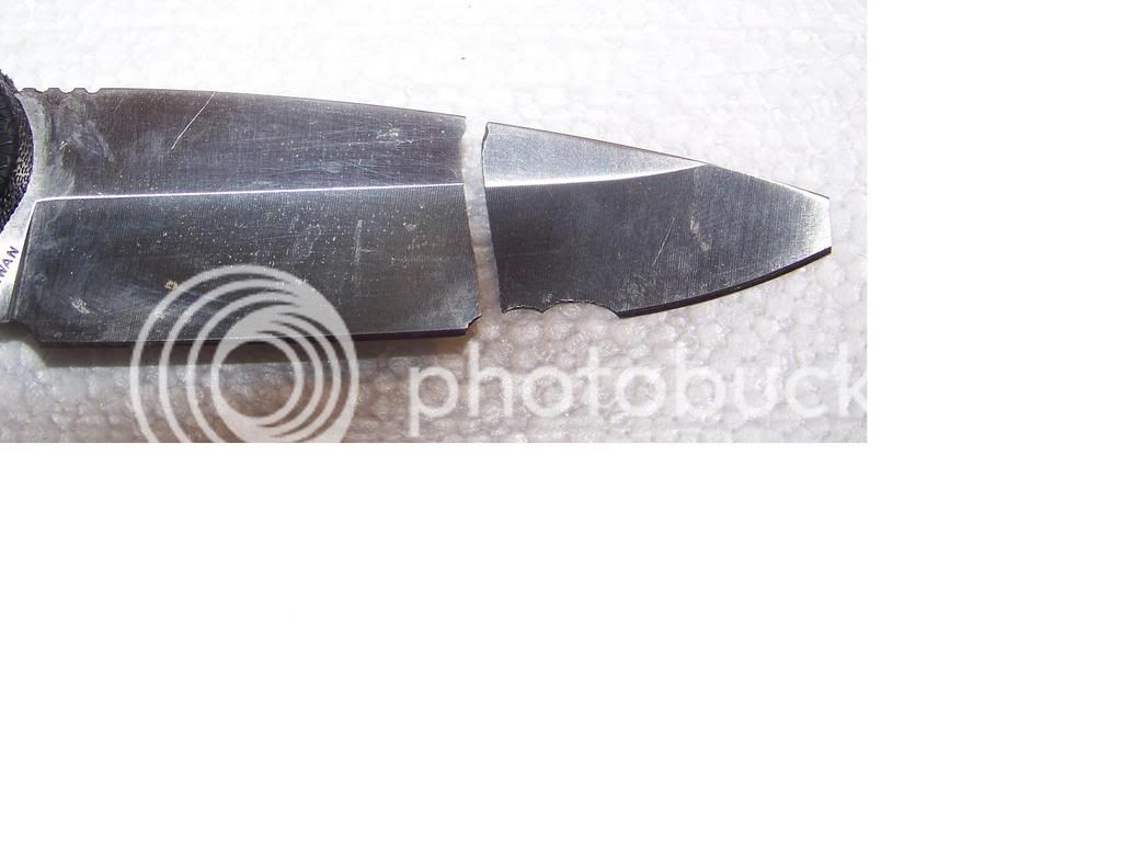

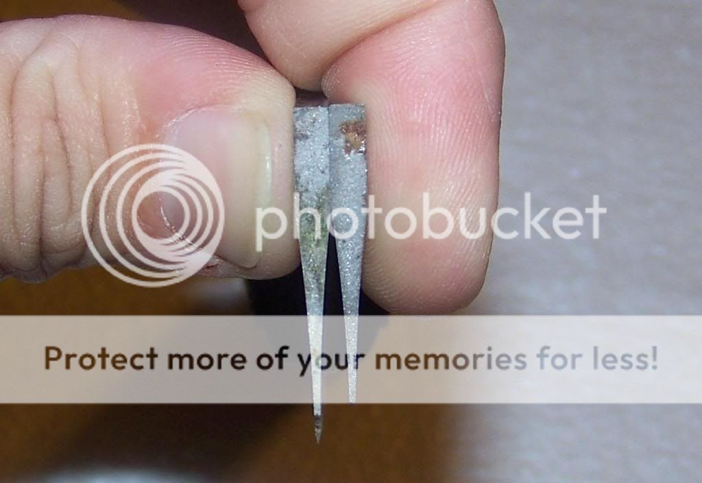

I didn`t really want to send the knife back to buck ,my buddy did pay about $25 not a bad price at the time (the diamondback that goes for $8 is the smaller model and both are no longer made and therefore on clearance) I just wanted to know what everyone thought they might say as I do not think it is abuse and as you can see in the pics I have there is a rust intrusion in the (stainless) steel the happened before the break as they are so cheap now he plans to buy another (loves the larger handle size on the diamondback ,not so much in love with the new omni models) these are a very comfortable quality knife a very good deal if you can find one and I for one wish they would have kept making it.
I just wanted to know what everyone thought they might say... as I do not think it is abuse and as you can see in the pics
Please don't take this the wrong way, I'm not trying to be rude or anything, but if you still don't think that is abuse I don't really think you want to know what others think ;)
Do you see the huge chunks out of the blade?
The broken tip is abuse ;) Maybe the knife shouldnt have split in half, BUT the tip breaking off and the chunks missing in the cutting edge is abuse... Once the knife got stuck in the pelvis, you can't twist the knife to get it out... I know I know, millions of guys do this everyday and noone ever damages their knives...
BTW, (JMHO) If I were to treat knives like this I would opt for a sturdier blade... maybe an Omni ;) maybe an axe! ;)
Did the "broken area" rust because of "materials left on the blade" after it was broken? OR was this rust evident the moment the blade split in half?
I don`t think batoning a pelvis is abuse having said that I don`t do it with anything thinner than 3/16 if an inch thick and even then usually not less than 1/4 and not with a narrow blade,and a few guys said they didn`t think it was abuse just not a great idea :foot:.the blade chunks left the blade at the time of the break all damage other than the tip was instant and not part of an aftermath AKA no twisting :p(tip broke off a few moments before,and might have helped him decide to go ahead and beat on the thing) and yeah the rust was there when it broke I have seen that before but not in stainless steel only in high carbon or plain carbon steel tools and knives a good reason not to rely on carbon steel for survival..no fun when the only knife you have snaps in half.

I found out from Buck during my blade breakage that there was a small batch of blades that had flaw in the steel and my knife was part of that batch. Your pic of the broken surface of the blade looks oddly similar to mine (I know nothing about steel or what a it should look like when broken):
