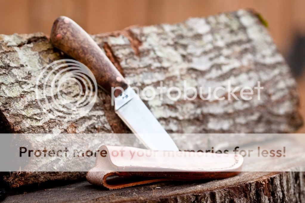

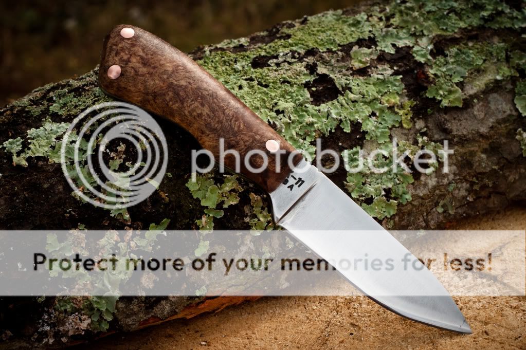

Thanks! I got some 80 grit belts that were 1x42 for shaping. I cut the belts and did it by hand. This gave it an awesome feel.the spine and scales are fluid and seemless. after i shaped the handles I used a 600 grit belt on the sander and then up to 15 micron. I then applied a layer of tung oil and wiped it off, let that dry for about 30 minutes and then took some 0000 steel wool to it and finished with a clean polishing wheel on a Dremel. Finally I applied another thick coat of Tung oil and let it sit over night. tomorrow it should shine up REAL well and then one last coat should make it high gloss without using lacquer. Cant wait to get started on the sheath for this thing!
I also reground the index finger area, thought I would point it out since no-one mentioned it yet!!

You get about another .5 inch of grip on it, which for me is just enough for all 4 fingers. I love the mod.
My only regret is that I meant to add liners and completely forgot. I got so excited to get started just totally slipped my mind.

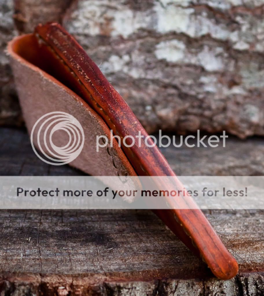

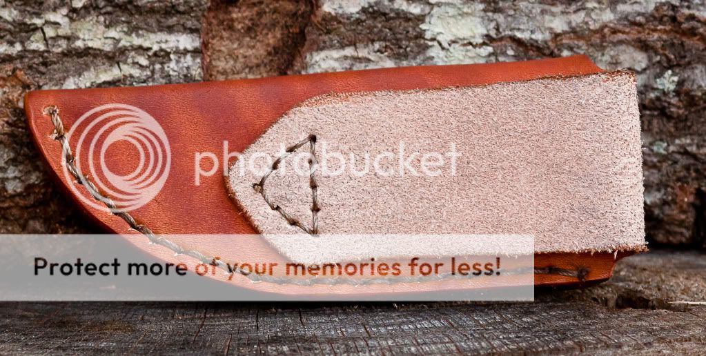

Hey guys. So I finally got the sheath done. I think it turned out quite Nicely!!
And because all the previous link were broken, here is the knife once more:
