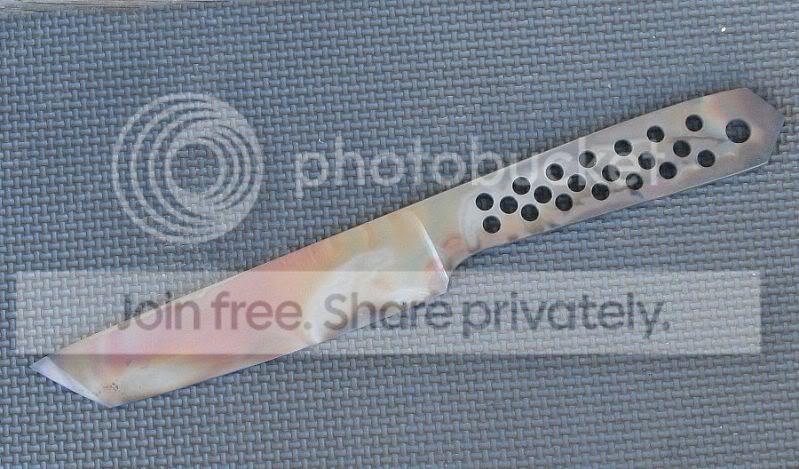

I just picked up a .172" S35VN blade I had TruGrit heat treat. Looks good and I want to grind a the clip.
Any tips or tricks on grinding the clip? I am not sure what a good angle would be.
Any suggestions?
Thanks
Each one is a little different. I used to record which angle I used on which knife; in the end I found it easier to place the blade against the naked platen and make the call by how it looks to my eye. If your grinding with a Bubble Jig; place the jig on the bevel with a piece of tape under it and set and lock the bubble as you are eyeballing your setting.
Post us a pic when you get it finished.

I was going to add the practice runs option; but I figured you knew that. If you work off a steady tool rest its rather easy.

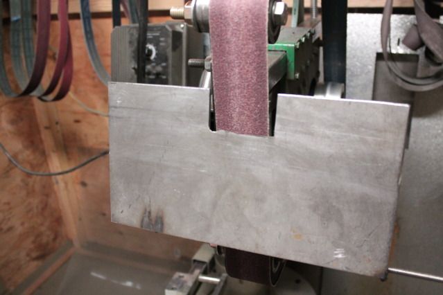

I use a large angled rest for most of my clips, I usually grind them pre heat treat.
Ben,
What angle is your rest?
I might have to make a set up like that.
I think it is at about 12 degrees in that picture. I change it depending on the thickness of the blade and desired grind height.
