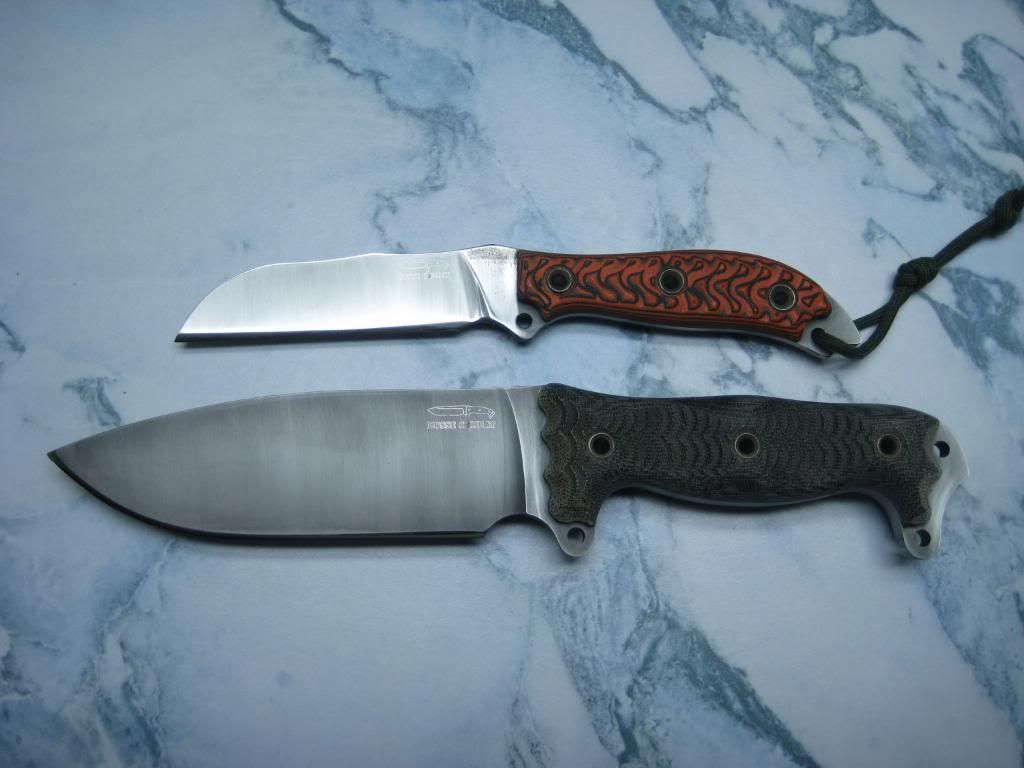

As you can see in these pics, the handles on the SS look normal now, but I sure was concerned about it when I initially washed them off. Part of that problem might have been the hot water while they handles were a bit soaked in stripper?
I would stick with the Kleen strip people have gotten great results with.
