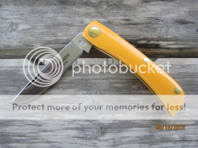

Just bought my first real traditional folder: Queen Country Cousin

BTW, I haven't put this knife down in 2 hours.
A Solid working knife
Nothing fancy
Will last for years

Okay, I spent a total of about 5 or 6 hours over the last 2 days resetting the edge bevel angle with the DMT Aligner including the time it took to actually sharpen it (probably less than an hour) hitting every grit from extra coarse to extra extra fine. I had to remove a lot of steel because the edge bevel angle from the factory was VERY obtuse and VERY uneven. Also, the new edge bevel angle is much more acute than the pic above this post which required even more steel to be removed. The new edge bevel is not pretty, but it's easily the sharpest knife I own right now. No pics because there's no good light to be had at 1:26 am.
I just kept flipping the knife in the clamp keeping the tightening knob facing down to make sure the edge bevel angle stayed consistant. This had a lot to do with why it took so long.
I'm now super excited about having this knife. I'll post pics as soon as I can. Thanks to everyone for the advice and pics.
Okay, here's a pic. The Aligner kit marred the finish some, which doesn't surprise me after the number of times I took the blade out and flipped it over.
Looks like you're off to a good start with D2! :thumbup:
I would recommend trying to avoid re-clamping the blade frequently. There's always at least a tiny bit of variability in re-positioning the blade in the clamp, and that'll take away from the angle consistency a bit. Having said that, it looks and sounds like you've handled this pretty well. Nice work! :thumbup:
