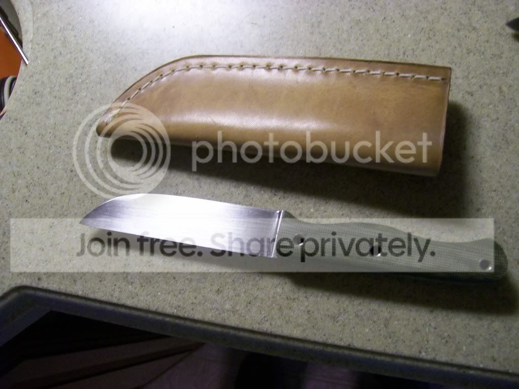

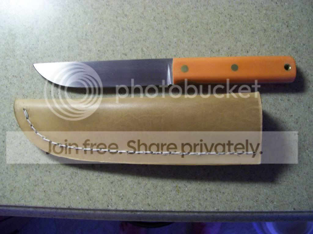

Hi all, Here is what I carry everyday. It has a 5" long
by 1/8" thick by 1 and 1/8" wide and is made out of
0-1 steel flat grind with and is convexed toward the edge.
It has a full tang that is 4.5" long with orange G-10 for the
handle scales. I use my knife from camp to kitchen chores.
Just to day I sliced up french bread and then spread on the
mayo for dried beef sandwiches. and then went out to cut trees
out of a farmers fence line, it always happens Kathy and I will
pack up all our chainsaws and bruchcutters on the ATV then
then there it is a little ceder tree :eek:right there in front of us.
Well if I can not pull it out then out comes my Pathfinder
and one less tree:D Here is a pic of it. and my wifes, heres has
a 4" blade and red G-10 scales for the handle.
To answer your ? on why. I designed it and made it and I like the
blade length of 5" for the all round use and carry I do not carry
a bunch of knives ( my chain saw is weighs enough ) so I am
kind of a one knife carry kinda guy. I do carry a little classic
swiss army knife but I use it for the tweezers and the sissors:D
Also the 5" does better at snap cutting branches than a 4" roughly
bladed knife.
If I did not carry a my Pathfinder then I would a Kelly knife as my
all found carry knife again with a 5" long by 1/8" by 1" wide 0-1 steel
blade with a 4.5" full tang handle with orange G-10 scales for the handle.
Easy to see if set down or dropped. This is a very comfy handle style too
and just a great simple user freindly blade. Here are two versions
of it same blade but different handle shapes and handle scales.
Well that is what my thought are any way. I am looking
forward to seeing what others have to say also.
Bryan
