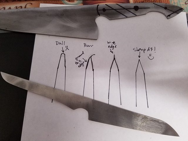

I tried to find a good pic online but instead drew this quickly instead of working on my own knives out of laziness. LOL! Note that I did not draw the bevels as convex to keep it simple (and out of laziness).
To me, sharpening is in general discussed with too much voodoo-i-do-this and not enough explanation of the hows and whys, kind of similar to some discussions about heat treating. Once you understand how and why, then however you do it yourself will be sound regardless of small differences in what tools you use or your technique.
Very good drawings. If the edge is convex, there will be no angle between the edge and the main bevel ... it will just curve down to the edge.
