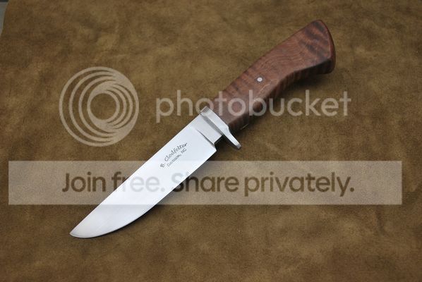

Here is my latest knife and I think much better than the last one. It is 1095 with 416 stainless guard and stabilized curly maple handle. Anything I might can do better on the next one?
Over all the knife looks great. The only feedback I could give by looking at the picture is the handle looks a little blocky. I could be the complete opposite in real life. :D
Nice looking knife. Looks great
Looks good!
Personaly I´d drop the point a bit but that´s a matter of taste

It's a great looking knife. I do agree with chavez on the handle - it looks a bit too square. I think handle comfort is extremely important; your knives shouldn't just feel good in hand, to maximise that chance of a sale it should feel "right" in your hand. Of course the handle could be perfect, it just looks a little square :)
Having said that, you have made a beautiful looking knife :D
Thanks guys! The handle is a touch squarish true but it is only a tick over .5" wide and it is very comfortable to hold.
When you put dissimilar metals in contact with each other, it can cause corrosion; i forget the proper name for it. However, makers have been putting stainless guards on carbon steel knives for a very long time with no problems. Also, if the guard/ricasso fit is sealed with epoxy, corrosion will be minimized. I've seen Barry's work. I'm sure this is a fine hunter that will outlast all of us. :)
