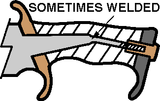

My only concern is the pommel were there seems to be a nut on the end. I assume that it was torqued down to hold the whole knife together. I never owned a knife like that, so I am not sure how much bushcraft abuse a design like that would take. Wondering if I should take it off and apply locktite to it for insurance. There again I have other knives better suited for bushcraft.
As far as a large cutting tool, it is a pretty cool knife. the steel is AUS-6. Don't know much about it other than it is like 440 A or something. BTW: Got a pretty decent leather sheath, put mink oil on it and worked it out some. Seems nice.
I'd be concerned that it might have a welded on rat tail tang. If it's an integral tang that's just narrowed down and threaded, that should be okay, but I don't know if they'd bother to do that on a knife like this. It's easier to just weld a piece of threaded rod onto a stub tang on the blade. I don't think I'd try any heavy use until I'd taken it down and had a look (assuming the nut isn't epoxied or something).
Good points. I have to admit...I hope this knive works out. I mean its just a fun big blade to play with, the balance is nice believe it or not. You think I should try to loosen the nut on it, and see what I can find?

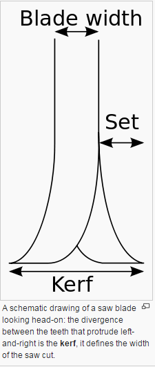

It's out of my interest range but I always wanted to put a kerf on those cutting teeth to see if you could actually do some real wood cutting like some actual shavings. I've used cutting teeth like that on other budget knives they usually just rub the wood to some ratty dust with a lot of my sweat. Maybe someone will try putting a kerf on one. As a Rambo fan I like the style of the knife. Interested in the tang construction too.

Yeah I am not sure of the tang right now...not sure how to check without taking it apart. Can you explain to me what a kerf is?
I think it'd be a good idea, but it's totally up to you. Obviously, if you do decide to do it and you start torquing on the nut and it doesn't want to come loose with a moderate amount of pressure, just leave it. :thumbup: I did some searching and couldn't find any actual pics, but I did find this drawing, which shows what I'm worried about (they even labeled it for me:D):
If you DO have a piece of welded rod in there, it could snap under impact (like during chopping, let's say), leaving the handle in your hand and the blade flying off who knows where. :eek:
If you are really interested, I'd take the nut off and have a look. The nut is what holds the handle and so forth on. Yes, I feel sure it is a reduced tang knife and as a result, probably not as strong as a full tang knife. I like this design. But I don't baton hard with the reduced tang knifes. Enjoy your knife.
Yeah I don't think this is the type of knife I would baton with anyway. As far as slicing and cutting stuff it works great. I think maybe light chopping.
Took it apart. It is a tapered tang but the skinny threaded part appears to have been grounded into shape from the primary piece of steel whether than welded. Also what gives me some comfort is the length of the nut covers quite a bit adding to the mass of the tapered tang.

One tooth leans left. The next leans right. You have kerf.
The result is that the slot you saw is wider than most of the blade - so it is less likely to stick in the work.
Professional woodworker here. What you wrote is correct, but the terms were a little off. The term you want to describe teeth bent to each side is "set." The teeth are bent to lean alternately left and right so that the slot in the wood (AKA the kerf) is wider than the body of the saw so that the saw (knife in this case) does not bind in the cut. The kerf describes the slot formed in the wood being cut; the set describes the lateral tooth displacement that prevents binding in the cut.
