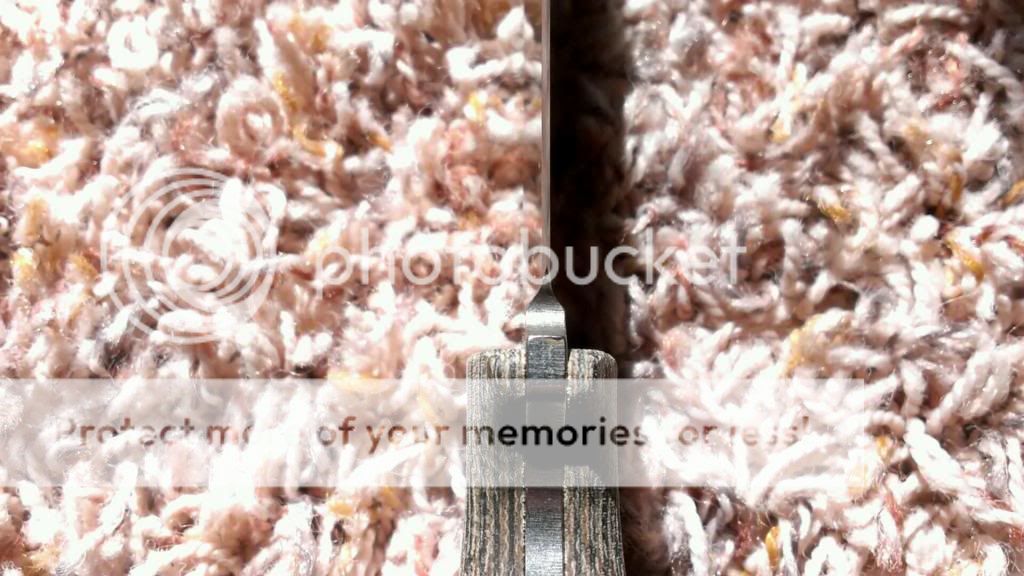

First off, I took some pics but apparently cannot upload them directly from my desktop. Anyways, I just got this in today, and noticed that the plunge lines are somewhat off. Is this normal, and should I be concerned? Also, Has anyone had issues with rust under the micarta scales? Thanks

My phone's camera sucks at close up shots, so I had to take a photo out of a video I made. Anyways, this is very hard to see in that photo. It's much more noticeable in real life, so I measured the difference between where the grind starts on each side and the right side starts about half of a mm before the left side does, maybe slightly less. Again, not at all a big deal, but just wondering if that is in spec. Thanks for the help guys. I'm probably just being nit-picky, but I'm curious.

My cutting edges are usually pretty darned centered. If I'm understanding this correctly Strong-Dog, what you're referring to is the slight difference in plunge radius leading into the cutting edge, when looking straight down at the grinding choil like in your photo there? I've enhanced it a bit, trying to understand what you're seeing that is giving you concern. If we are on the same page, you are talking a few thousandths Man...

I honestly don't see anything at all wrong or out of the ordinary with your blade but if you do, please feel free to return it for an exchange or full refund. This link will get you started: https://surviveknives.com/sales/guest/form/
I appreciate you taking the time out of your day for that response. As long as it won't structurally weaken the blade or affect performance, I'm fine with it:) I do love the knife though, it's one of the most comfortable knives I've held. Also, the finish on the blade is probably the nicest stonewash I've seen.
