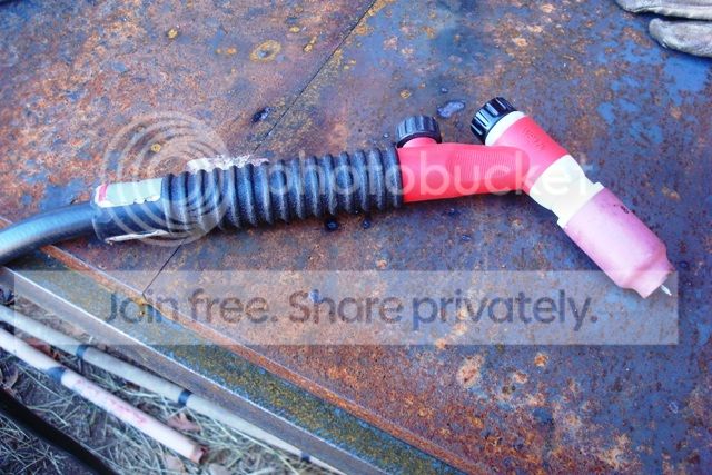

Well, a week after I got the stick welder, I was at a local pawn shop looking at some guns, and I happened to browse over their tools, and happened upon a complete tig setup for a stick welder. Leads, weldcraft tig rig, and victor flometer. All in good condition for $150 :eek: . Needless to say, I jumped on it :cool:
So, I am happy to say, I am now welding capable, both stick and tig. Yay me! :D

As for tig, yeah, if you have a dc option on your stick welder, you can get a scratch start tig rig. You hook the ground to your work, your stinger clamps to a connecter on the tig lead which also hooks to the argon. They're a great option for tig welding, you just can't run on aluminum cuz you don't have high freq. The college I went to taught us tig on these style rigs to start with.
And I always use 3/32" dia 2% lanthanated tungsten for my electrodes (when not welding aluminum).
