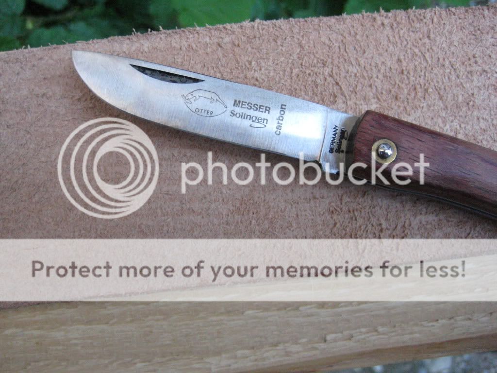

I built two of them a couple of months now. One I run with compound, the other one I use with leather only.
I prefer the "just-leather-strop" before the one I run with a aluminium-oxide-compound.
It just feels better while stropping. You just have to look on a lower antle than during sharping. On a 20° edge (each side) I use to take a 10° or 12° on the strop.
Let me tell you, I used an old leather belt for stroping before I got these two self-made-stropes.
My well used strop some months before :D
