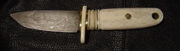

Thurstan Joined Dec 29, 2005 Messages 30 Jan 23, 2006 #1 my new damascus tanto, chainsaw damascus with a file and leafspring core, elk, reindeer, ivory, and brass handle.
R randydance062449 Straight Razor Guy Joined Nov 25, 2005 Messages 109 Jan 25, 2006 #2 I like that knife! How many layers of each material did you use to start with?
Thurstan Joined Dec 29, 2005 Messages 30 Jan 26, 2006 #3 I used three 16" chainsaw blades for each side billet just over 100 layers, and the file and spring were about 200 layers.
