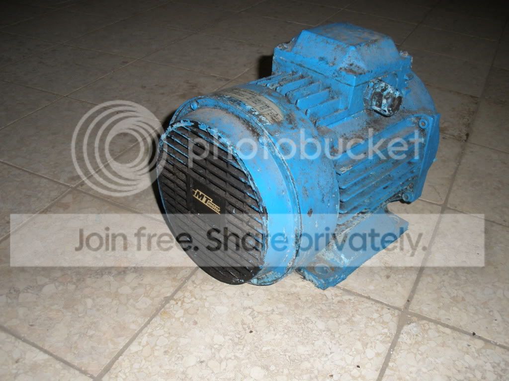

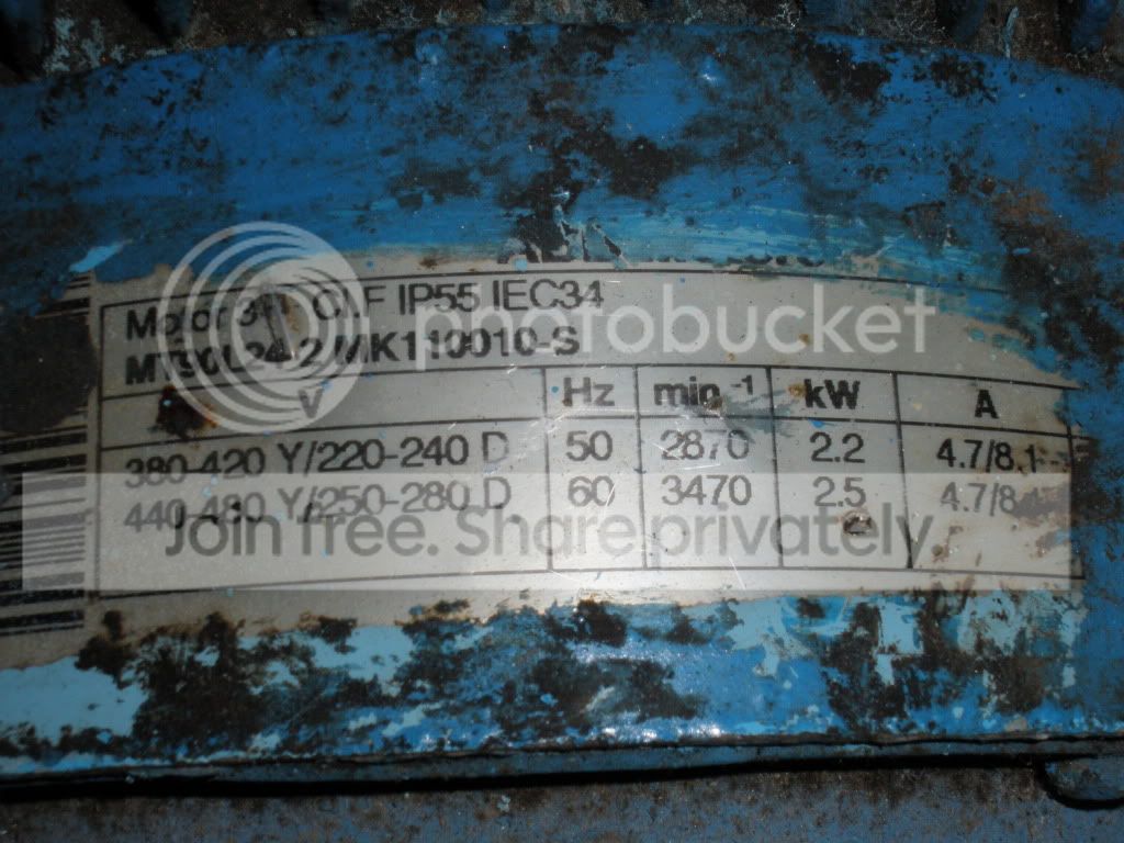

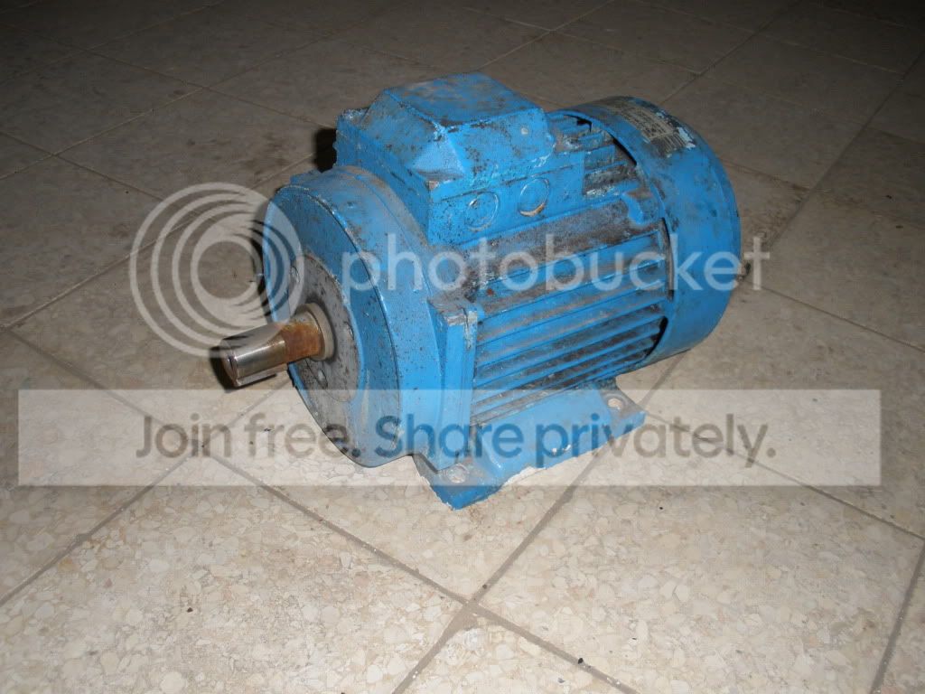

Hi everybody. Pls find attached some pictures; I was told that this engine is from a broken pump from an ice-cream factory (?) and is in top order (and for free:D). I will thank you all if you can give me some advice:
1. Is it possible to run it with a variable frequency?
2. Will it be good for a disc sander?
3. What will the best way be to build/attaché the work rest?
4. Any other comment or idea?
Thanks a lot – Michael.

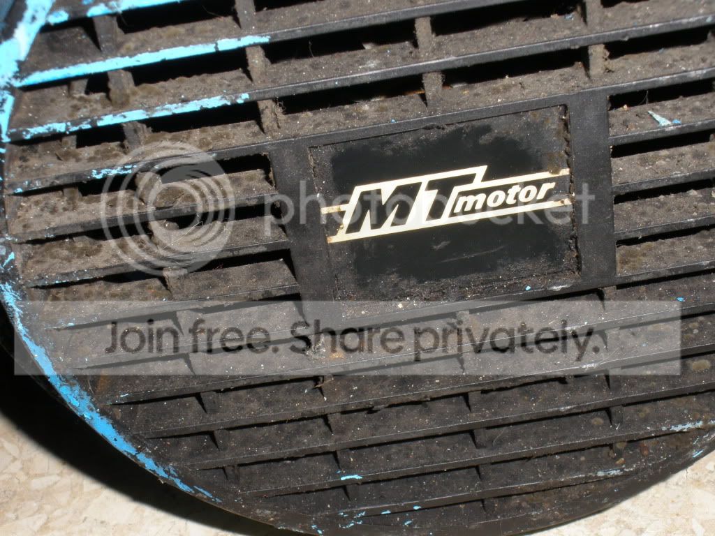

I don't find any info on that motor that I can read.
It looks to be 220v
the question I would look for is whether ir is single phase power, or 3 phase power.
single phase no VFD, three phase VFD is possible
I don't see a starting capacitor, so it is possible it is 3 phase.
See if you can find your motor in their catalogue and ID the specs.
http://www.electricmotorsmt.com/eng/index.htm
http://www.electricmotorsmt.com/pdf/gen-mot.pdf

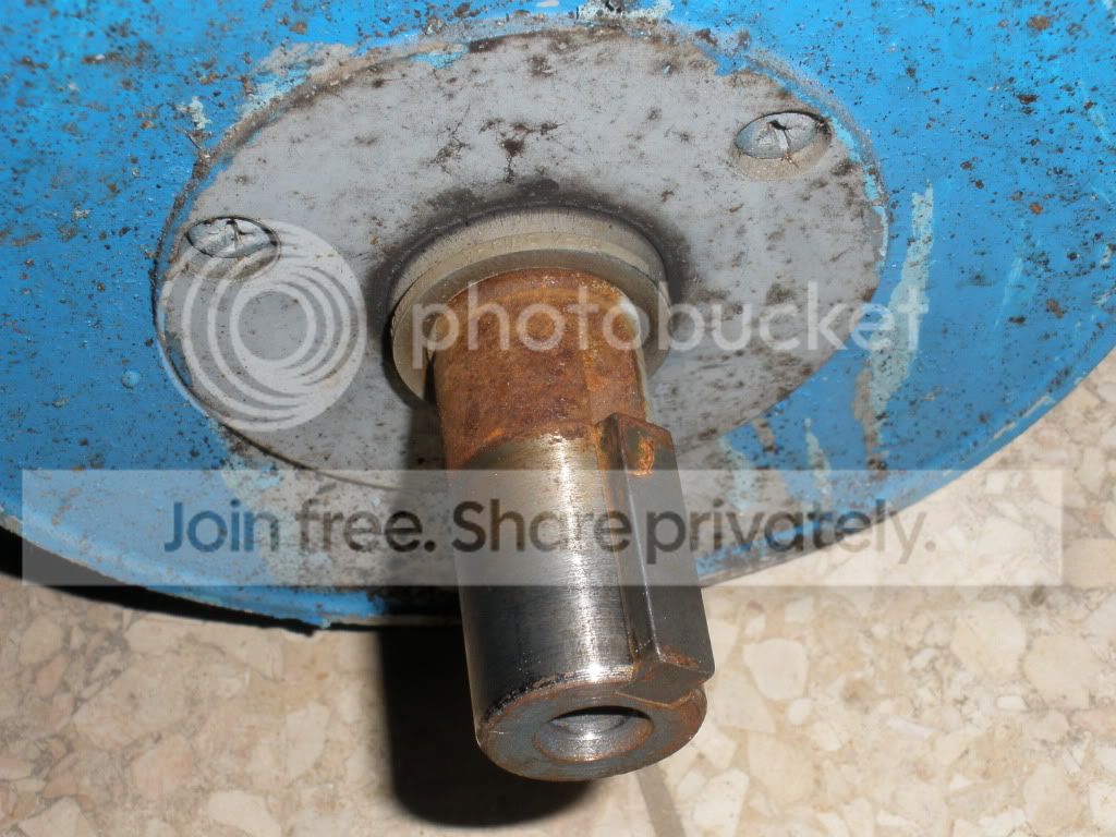

Most disc have a 5/8" shaft requirement. You'll want to mic yours to see what size it is.

the OP's motor is a 3 phase motor that can be wired wye or delta
you should be able to run this with a properly selected VFD
depending on how you wire it internally (it can be changed) both for voltage and coil configuration (wye or delta)
it can be powered by these voltage(s):
50 hz
380-420 wye
220-240 delta
60 hz
440-480 wye
250-280 delta
a VFD can do phase conversion (1 to 3) and voltage conversion, say 220/1 input to 480/3 out
the drive must be sized for the amps per input leg if going 1 to 3 phase, basically 1.73 (sqrt(3)) times the load amps
then calculate KW rating
if you run this in 50 hz / 240-1 in / 240-3 out
the motor at full load will draw 8.1 A at 2.2 KW (VA = 8.1 x 240 x 1.73 ~ 3360 VA, eff or eff/pf ~ 2200/3360 ~ 65%
drive should be 1.73 x 8.1 x 220 ~ 3.1 kVA ~ kW or next larger size ~4 HP
this is becasue the output will distribute power over 3 wires/phases at 8.1 A each
the inoput will only have 2, so will carry more for the same power
i = 3360 / 220 ~ 15.3 A (~ 1.73 x 8.1 ~ 14)

To use a wye/delta motor on a VFD you have to hook it up as "across the line on the delta run connections".
Connections used are determined by for the voltage output of the VFD.
If this is Greek to you ( or Hebrew to others) get someone who understands these words to show you the six wires needed for connection.
What you need to know:
Your voltage at your shop - 220VAC 50Hz single phase (most likely).This will also be the VFD input voltage.
The VFD output voltage - It will need to be 220/240 VAC 3Ph for this motor.
What you want to know:
The six wires and how to connect them for across the line delta run.
Thank you all for replying; most things where indeed Greek to me (or Hebrew to others :)). Anyway, it was a pleasure to read all the replays and learn a bit more, see other points of view even when it came a bit out of the main issue.
I do have a 3 phase supply at my home and I can phone the guy who delivered me the engine, he will know all regarding the electricity, so I don’t expect many problems from this side.
Main difficulties I can see are the technical ones, regarding of where to purchase the 9” disc(s?) or how to make them, and how to approach the rest / table thingy, as I want it to be strong, flat of course and with a hinge-out-of-the-way system, in order to change discs rapidly and comfortably. I could not find lots of info regarding this issue, and most self made disc sander where crafted from timber, which is out of the question for me (I do metal, not wood).
I thank you all – Michael.
