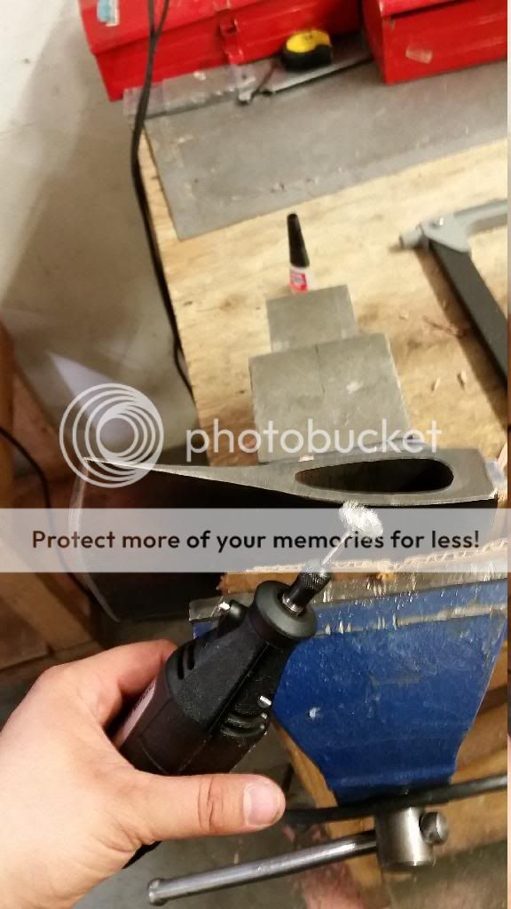

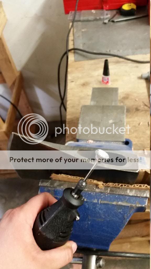

"Now the next problem, there is a hell of a lot of rust on the inside of the eye, I don't want to ruin the patina by soaking it in vinegar but I would like to get rid of all that rust. I don't really know what to do."
I've used a 12 Ga. brass cleaning brush, chucked in a variable speed electric drill to clean out an axe eye. Seemed to work pretty well. I'll bet any gauge or caliber brush would work. A rifle brush might be a little stiffer and get in the narrow part of the eye better than a 12 Ga.

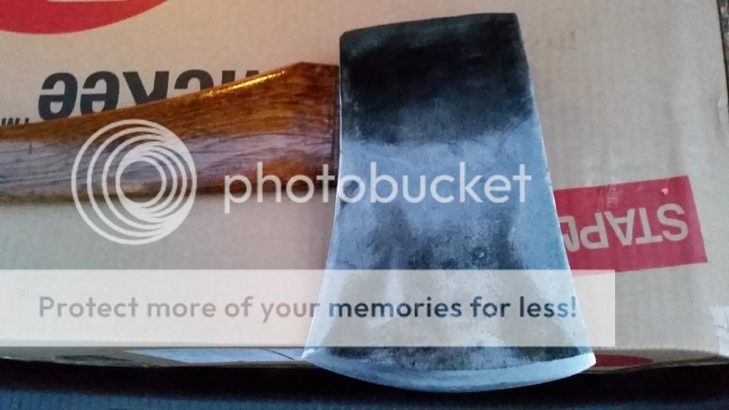

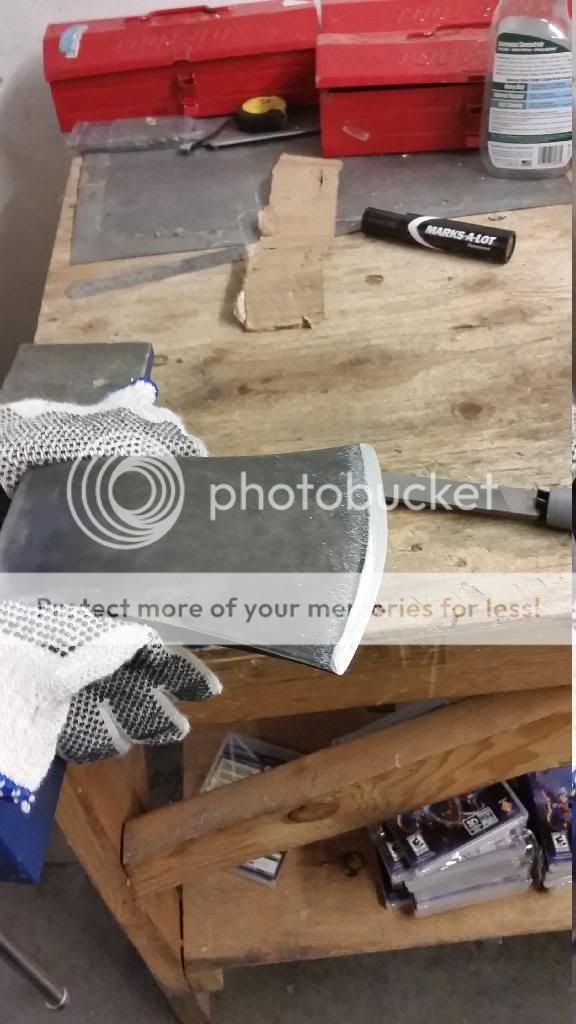

So I reprofiled the axe--my first sharpening on my beloved Connecticut. I hope I didn't ruin it.
I may have made the bevel too big, I was just trying to get it to 25 degrees. I was using a bevel gauge. I tried to keep in mind the U.S. Forest service recommendation on how the angel should be, not straight but sloping. I hated that I had to practice on this axe but I think it turned out okay, and I guess I didn't do anything that can't be fixed. It appears to be 25 degrees now.
One may notice that the axe head is not completely seated on the handle. I think this happened because I drove the wedge in while standing on a rubber mat, and maybe it was causing the head to bounce upward. By the time I noticed this, it was too late. I either scrapped the wedge and tried another day, or I just continued with a flaw. As I only have access to this shop while I'm at work, I chose to continue since they were closing up shop. If it gets loose, I'll do it again on a better surface.

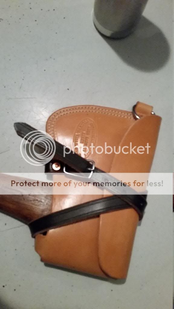

Here's a pic of it in my sheath from "Outlaw Saddlery". You can get it on ebay for about $50

Ya done good lad. You get a pat on the shoulder from me. Any sharpened axe is better than a dull one and the boys 40 years ago would have laughed themselves silly to hear there were arguments about how to go about doing this.
Thanks for the advice square_peg, I still have to buy a rasp, I think I'm going to wait to rehang it when I either get bored of it or it loosens, whichever comes first.
@300Six, thanks, I don't think I Messed it up so thats all I can hope for. This took me about 3 hours to sharpen. I only used a bastard file instead of a crosscut coarse file. I figured id rather take longer than make a big mistake. I still have to sharpen with my dmt diafold. At least the reprofiling is done though-for now at least.
