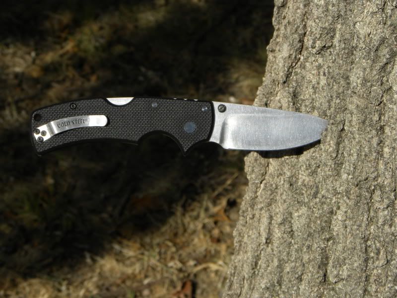

here's mine
also did a touch up with my
lansky after taking off the coating..

Ahhh that looks awesome, I'm gonna get some Jasco real soon and get that coating off! In case your wondering, Jasco is a gel type paint remover and not a thinner. It takes car paint off to metal so I'm sure it will work like a charm on CS' coatings.
thank you sir..

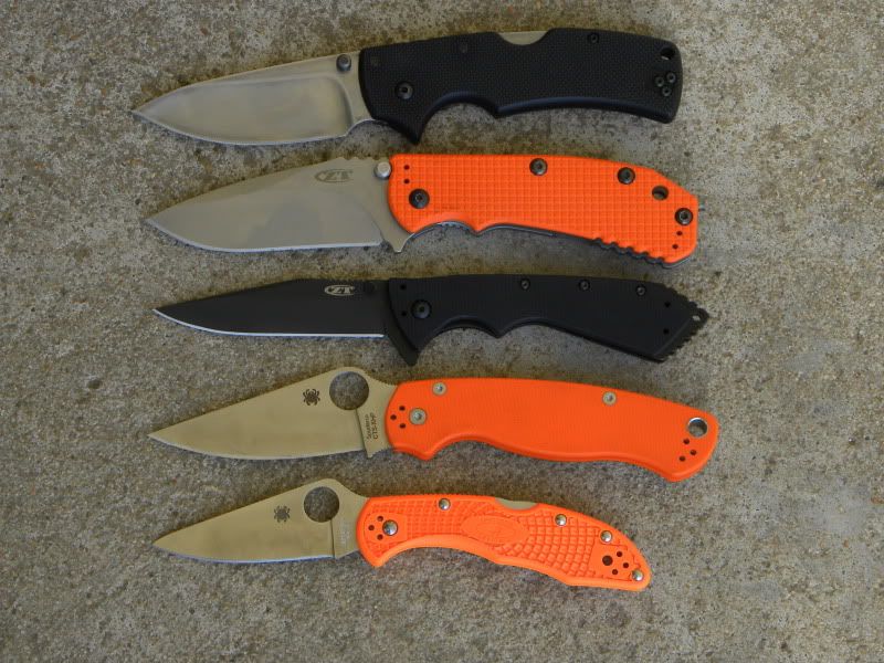

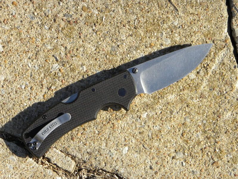

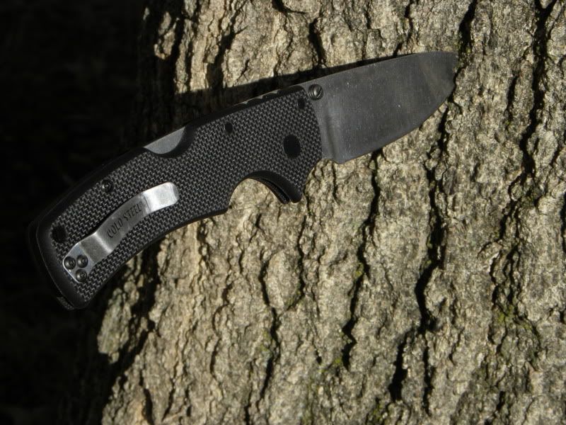

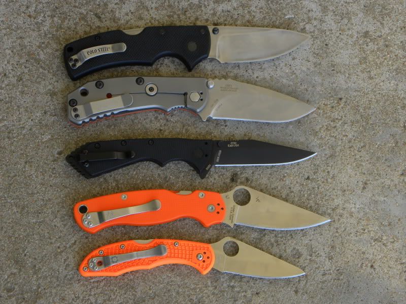

Hate to bump an old post, but I finally broke down and stone-washed mine (a-la the Ghetto stone-washing with a bottle of rocks in the dryer) and I'm not unhappy with the results (I only left it in the dryer for about 15-20 mins - I will probably do the pocket-clip longer as it still looks a bit rough).
Here it is after I stripped it (don't have great pics, but you can see it's been sanded on):
And here it is after my Ghetto-Stonewashing attempt:
All said and done, I'm pretty happy with it - the camera picks up a lot more scratches from sanding than you can see in person. I'd like to do the pocket-clip for about another 30 mins, but the lock-bar and blade turned out pretty well. I'm thinking of picking up a tumbler so I can do this more often. I hate black-coated blades except where they're needed in specific applications (i.e. not my EDC), and I'm not crazy about black pocket-clips either.
If I get brave enough, I'll take apart my ZT 0780 and do the liners, blade, and pocket-clip.
