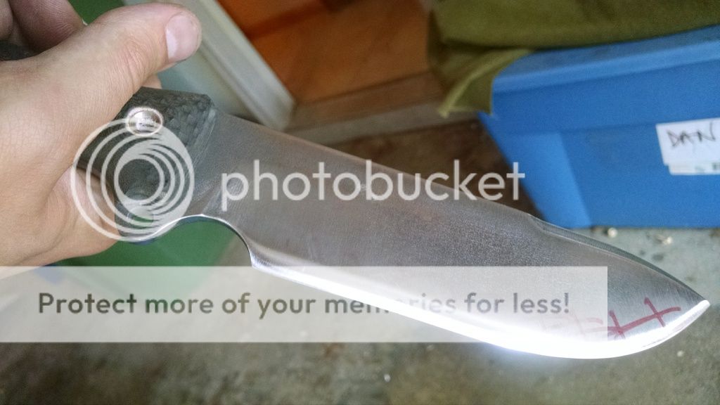

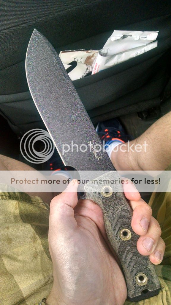

I had some extra time today, so I decided to make my newest addition to the collection feel a bit more at home.
Before a Citri-strip bath:

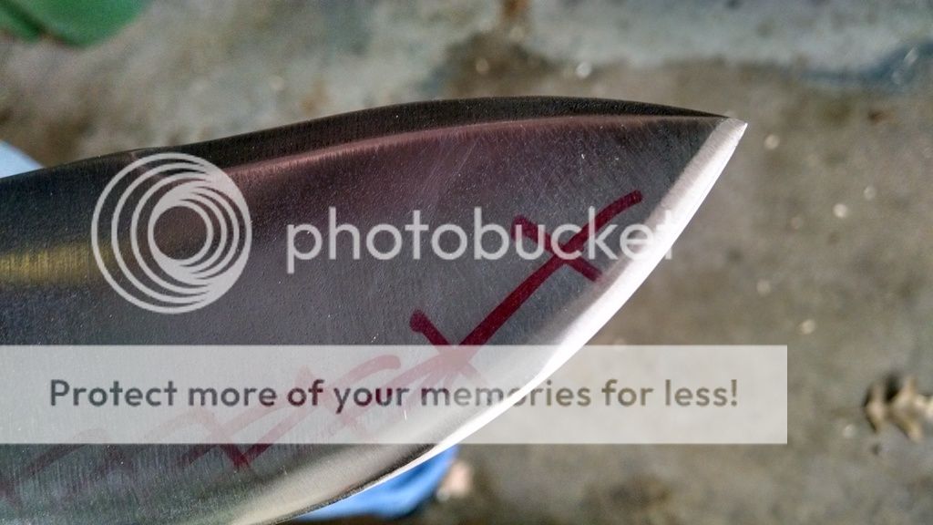

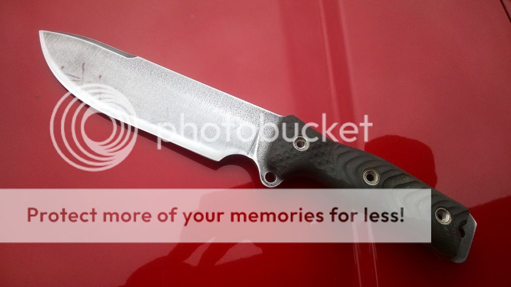

In all of its glory. I think I did a pretty ok job sharpening this one. Push cuts paper with ease. This is probably the sharpest blade that I own.
I can attribute that to the progression of grit, patience, and some RED SHARPIE! :thumbup:
The tip is still intact. Glad I didn't mess THAT part up. :)
Thanks for looking everybody.

Looks good! Get that bad boy oiled up ASAP or the decarb will rust very quickly.
Nice job. Got some dimples, cool.

Never used paper wheels. This is all harbor freight baby. And a surgi sharp leather strop belt for the 1x30

I used citristrip. It's the strongest that I use anymore since destroying the porcelain in my bathroom sink...... There's some strong stuff out there. Citristrip is all that you need if you wrap it in my hat and let it sit.
The scales were left on. I used a plastic butter knife to get in the books and crannies. Then I hit it with a scotch brite pad in a mandrel drill attachment.
Those scales are just plain DERRTY! Haha. It was very warm in my garage whilst doing this, and they soaked up a bunch of sweat. A bit o' dishsoap clears that right up.
