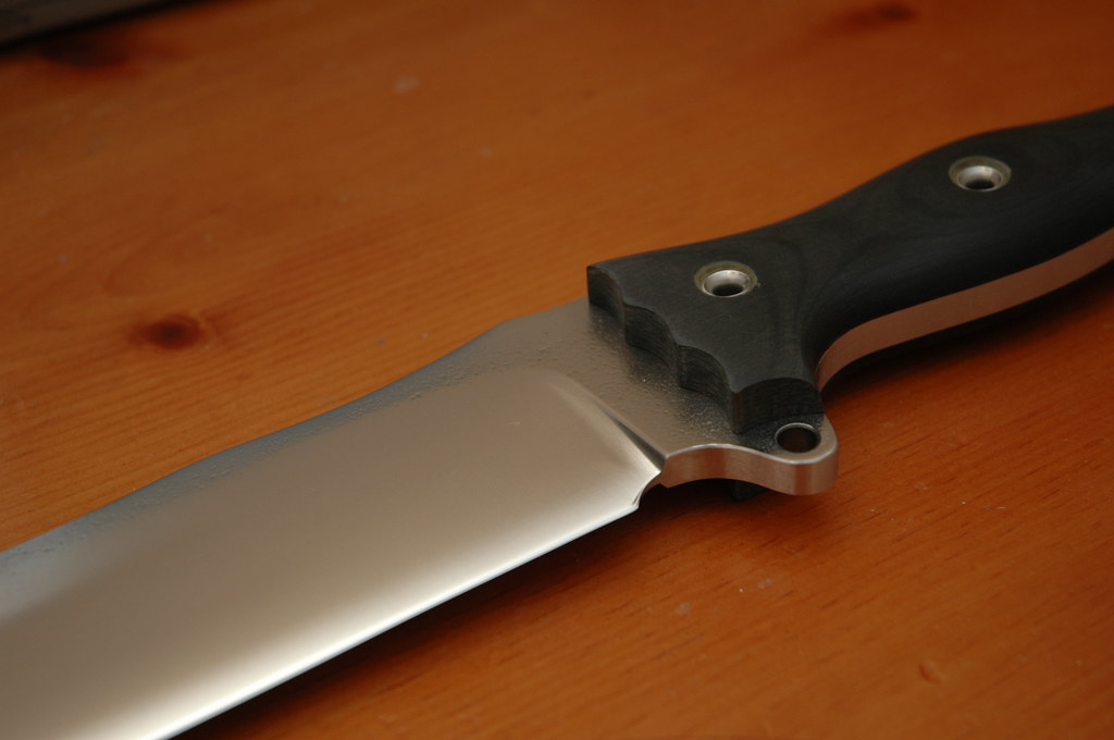

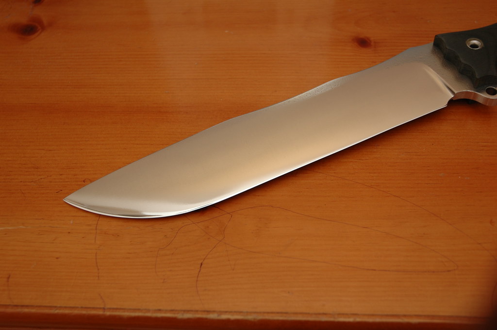

it started life as a standard black crinkle blade/magnum slab blk/blue G10 handle FFBM......
the one on the bottom of this pic:
it was mint when i sent it to ban.....brand spankin new...
i had ban do a few things......
the blade was stripped and given a frosty satin finish......the flats retain the dimples, but they were smoothed out a bit and the satin finish was applied over the dimples.......
the primary bevel was frosty satinized with the grindmarks running vertical.....ie, spine to edge......
the edged is a classic banned edge......mirror polished zero convex......
ban also replaced the blk/blue G10 magnum slabs with black paper micarta slabs.....thickness is right between magnum and standard thickness......and the slabs were hand smoothed and given a high polish...
here she is after her makeover:

Not sure what pic you posted because pic no worky. Here are a few pics that I took to hold you guys over ;)
now thats a winner!
Man, your finish is the finest!
Scariest edge Ive seen:D
