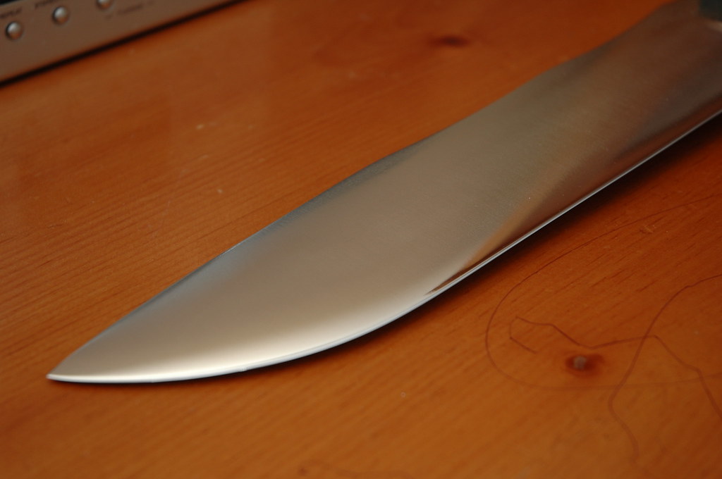

justed got my banned FFBM!!! oooooweeeee!!!
I had thought about a logo for my mod work sometime back but dropped it because I did not want to take credit for Jerry's work and design. I think a combo logo like Banned Busse would be cool. It would have my mark and still give credit to Jerry. But then again... Since the knife will no longer be covered under Busse warranty I am not sure how Jerry will feel about that. I will have to ask him about it the next time we talk.
actually, the only significant change would be the zero convexed edge......all the other changes were cosmetic in nature......satin finish, new grips.....
i know that since the handle slabs have been totally replaced, and not just recontoured, they probably wouldn't be covered under warranty.....
however, the blade itself should still be covered as no structural changes were made......the coating was just stripped and given a satin finish.....

That is an awesome conversion!
I really love those scales, they look perfect.
Holey Moley! That's one very shiny sharp edge! And I really like the new smooth grip slabs as well. I bet they would be more comfortable than the standard machined grips.

Thats an awesome FSH! :thumbup: I stripped, convexed (not zero edge) and put a satin finish on all by hand, and if I broke that knife I would still want to be covered because I think that I did not modify the knife enough to affect its performance.
How do I get an edge like this?
Easy! Just grind it in with a belt grinder. :D Start with 36grit, then move to 80, 120, 220. Finish off with scotchbrite then polish the heck out of the edge with a leather belt. Thats all there is to it :thumbup:
