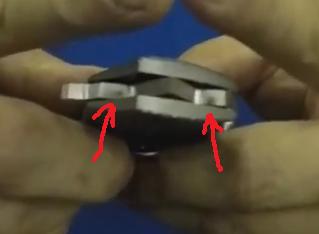

Announced this year at Blade was a new folder from Justin Gingrich which features a new evolution of the liner lock that he calls the "Delta Lock."
It features a "V" or "W" shaped lock bar interface with the blade tang that he explains provides for four points of contact instead of the usual one. Additionally, the liner is milled in such a way that it is inset into the frame with a similar four-point, "V"-shaped interface. There are multiple videos about it from Blade but here is a brief one:
At 1:12 you can see two wear spots on the blade tang:
I am truly interested in whether this represents a "stronger" (by which I mean "less prone to fail") liner lock. This seems like it adds a LOT of longitudinal strength but liner locks were never prone to fail in that direction. They are prone to failure by overtravel, especially in an inward direction. I wonder if this design relieves that issue to any degree?

I don't get the point of this lock. More contact surface isn't the way to solve the liner/frame lock slipping or deformation issue. This sounds like it would be a nightmare to get the surfaces to all contact at the same time, not even considering what happens once it wears.
Liner locks seem to fail mostly because of poor engagement geometry, not buckling. This does nothing to help that, and makes it much more complicated and difficult to achieve instead. I don't know why anyone would want that.

Hoback is working on an updated linerlock as well which features more contact surface. I can’t remember what its called but basically a U shaped tab on the end of the lockbar fits into a U shaped cutout on the back of the blade. That U shape cuout progressively gets tighter as the tab goes deeper into it supposedly providing a surface of contact around the perimiter of the U.
SpySmasher SpySmasher thanks for sharing this. Unless I am mistaken this Gingritch lock contacts at the spineside of the blade as well as on the edge side potentially meaning no stop pin.
Other knives have done something where there is no stop pin like the Ontario Dozier Arrow and CRK 45 lock. I believe the Arrow tended to develop lockup issues from this arrangement.
