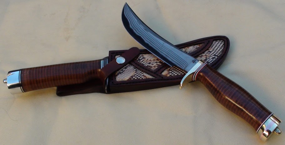

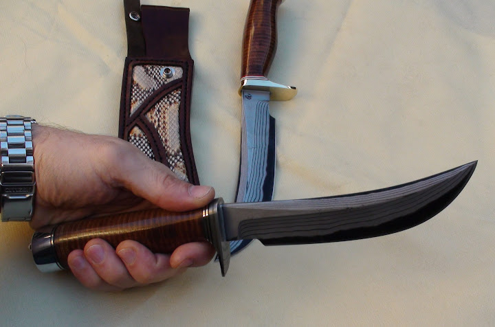

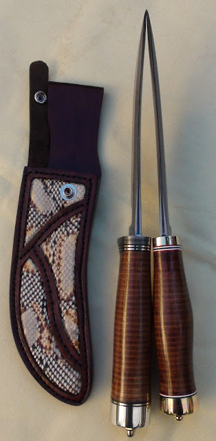

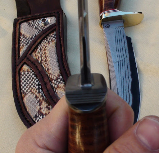

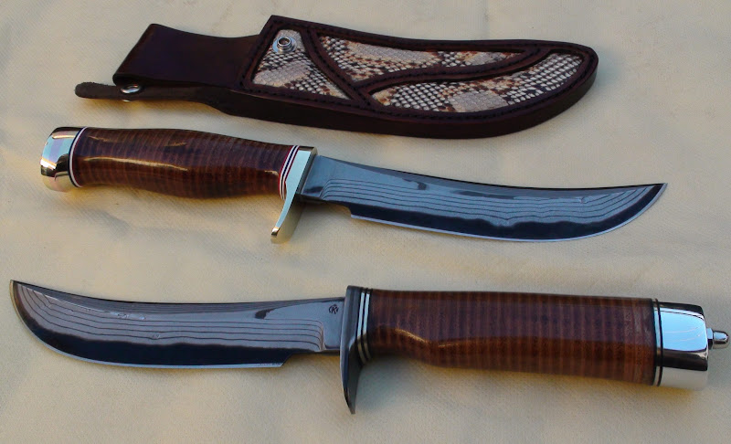

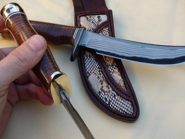

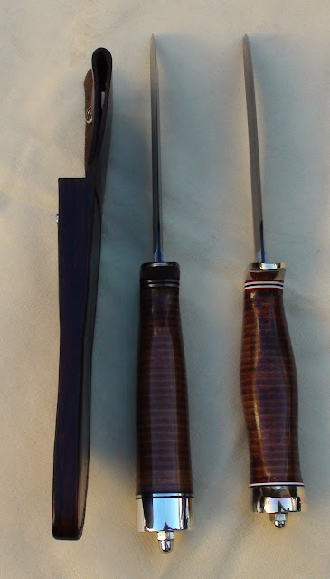

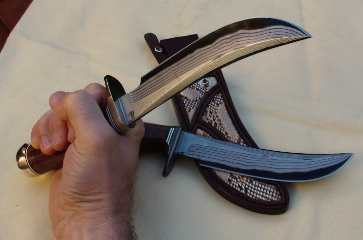

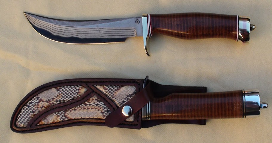

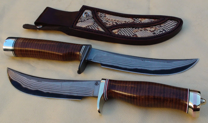

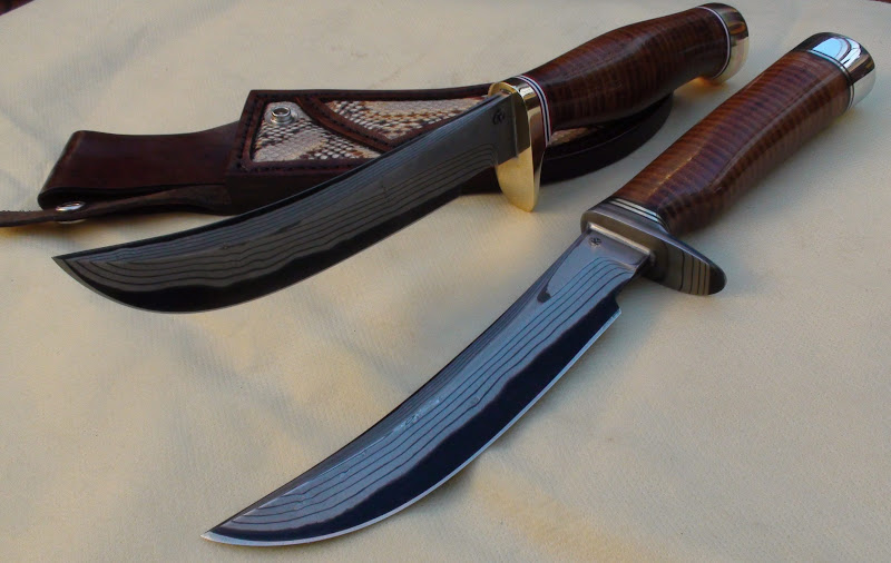

A reinterpretation of Randall Model 4 / 6", the "big game and skinner".

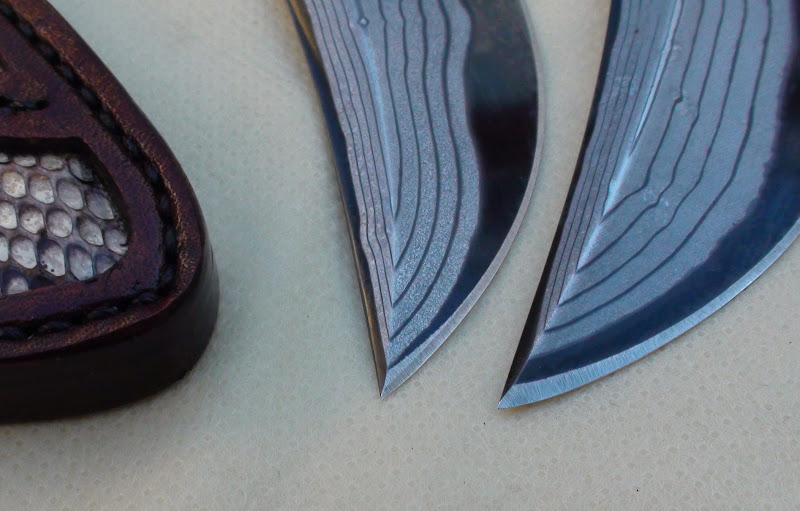

For both, 5,2mm suminagashi steel, with white steel core.
Forged and curved, oil hardened.

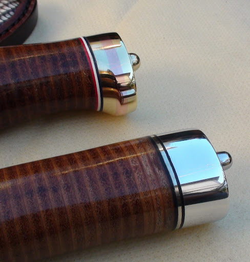

Handle discs of leather, carnauba wax finish + beeswax.
Very very sharp.

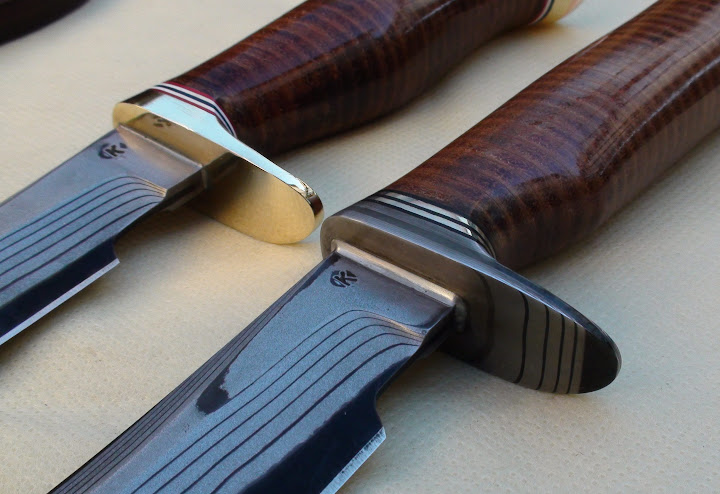

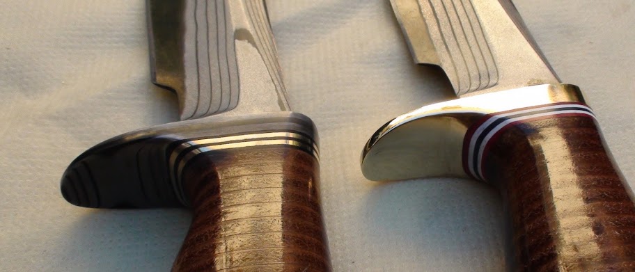

a) Hardened Suminagashi guard, vulcanized fiber/nickelsilver spacers and duralumin pommel.
b) Brass guard, fiber spacers, brass-copper-brass pommel.
Python steaths and a (not finished at that time) crocolike one.
Tons of pictures.... (sorry)
Bye bye.
K.
Beautiful... I think I'd give the nod to the one with the contoured handle. Excellent job keeping the layers even BTW
