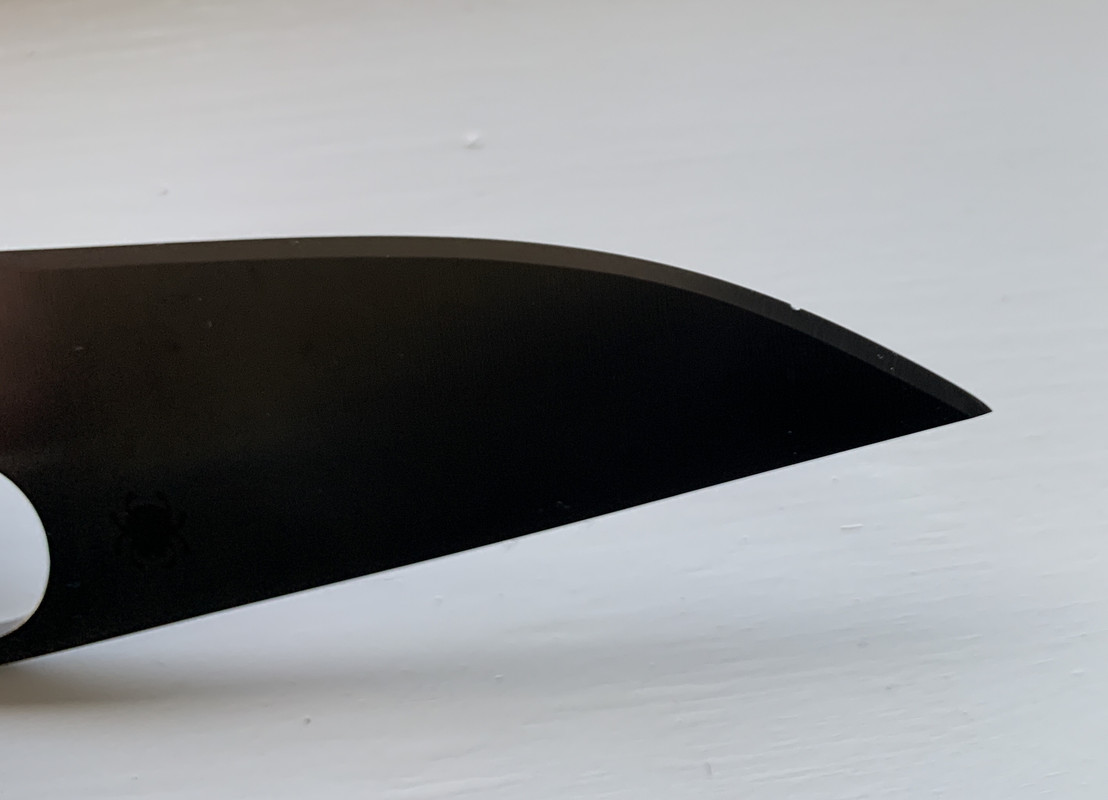

Makes sense. Even the best steels have limitations. I too enjoy how easy K390 is to touch up.Side loading the edge with pruning cuts in the farm and same with weeding woody shrubs with the knife. Not big chips, micro, but happens regularly enough. I could sharpen with more obtuse edge geometry and not have an issue but like the way it cuts with a thinner edge.
The toughness of K390 is on the low side for me and has higher carbide volume than I usually like for edge stability but it is working out well enough. Not hard to sharpen out the micro chips on diamond plates.
Yes all steels have limitations and when you exceed the limitations you have failure.Makes sense. Even the best steels have limitations. I too enjoy how easy K390 is to touch up.
With your 2 fairly heavy lansky sharpenings you most likely thickened the edge which added more edge stability.The only blade steel of any type that I had a chipping problem with was on a Spyderco (several years ago). I had bought two different Native models, one in CPMS30V and one in VG-10 to compare the steels. One of them, I think it was the VG-10, chipped like crazy after field dressing a whitetail deer and then more during normal EDC use. After the second fairly heavy sharpening with a diamond stone Lansky set, the chipping stopped and the steel performed wonderfully.
I theorized that whoever originally sharpened that blade at Spyderco may have overheated it? Hopefully, your K390 will stop chipping after you have a bit of that original steel sharpened away.
Sorry the Lansky I know the recommended bevels were all a little obtuse."Thickened the edge"?
I didn't change the secondary bevel angle at all. After a couple of good sharpenings, the thickness behind the bevel may have increased a tiny bit, but that has no effect on the edge stability; the secondary bevel angle was unchanged.
if the knife had continued to chip, my next step would have been to increase the bevel angle and/or convex the edge.
Maybe and very possible. I have sharpened my K390 knife a decent amount over the last couple years and I still chip it.Do you not have any experience with factory edges that ran hot, or is it by and large a myth? I've had a similar thing happen with D2 chipping, took a few good sharpenings and now it holds up great (but I did convex it).
