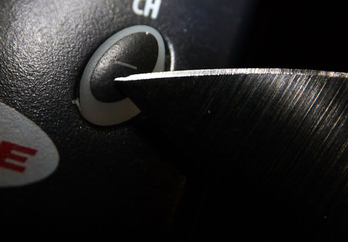

That's good information for me. I've been slowing coming around to understanding that these "super steels" don't mean invincible. From what you said, they simply perform the intended function of a knife more absolutely.
I do try to use knives as they're intended, but a lot of the time expediency wins out, but only with knives I know will handle it or I know I can fix.
As for the super blues, the only blade I've chipped is the SB mule. I got a very small chip off the factory edge pushing a spring in on a watch band:
Thanks for the info! I have lots to learn.
