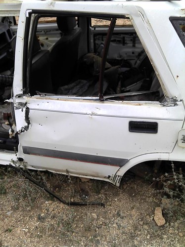

Mid '80s Hyundai.
Before

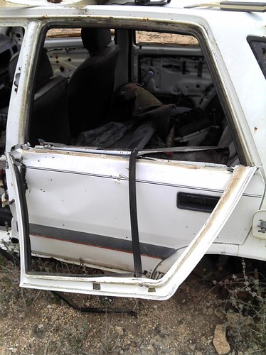

Cut out the top hing, cut the bottom of the window frame almost all the way through so it would hinge down but not fall off.

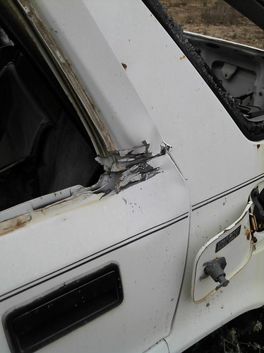

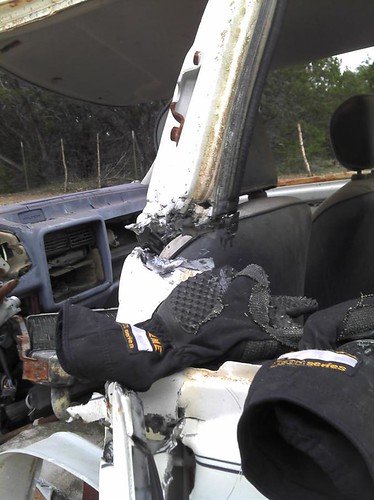

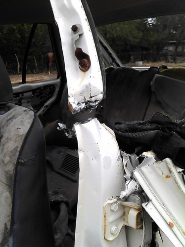

Then I proceeded to cut through the B pillar.
I used the spike to weaken the steel, then cut it with the blade.

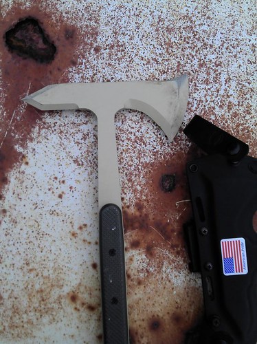

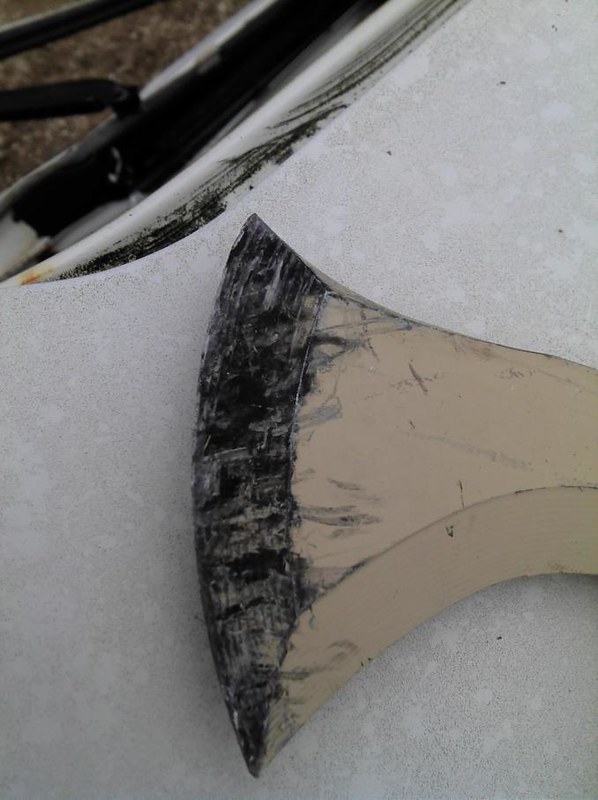

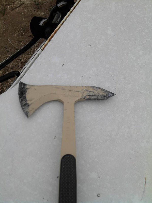

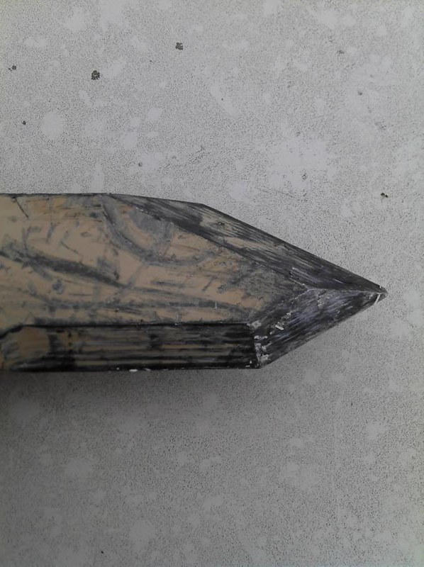

Hawk afterwards.
The only thing that it did to the hawk was blunt the spike a small amount and knock a couple very small chips from the blade.
There was really no rolling of the edge or weakness that I could find.
