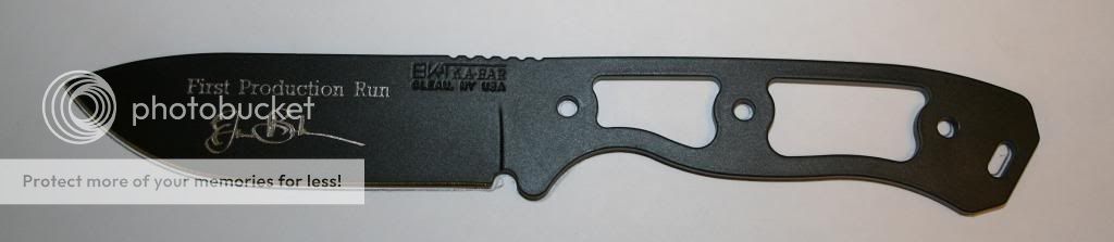

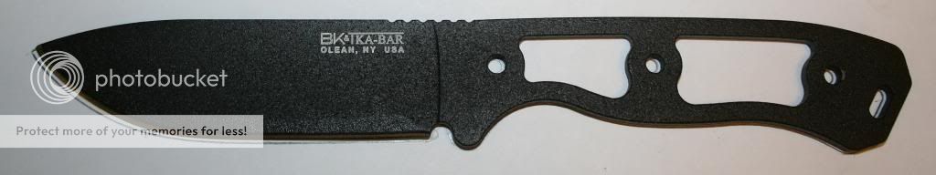

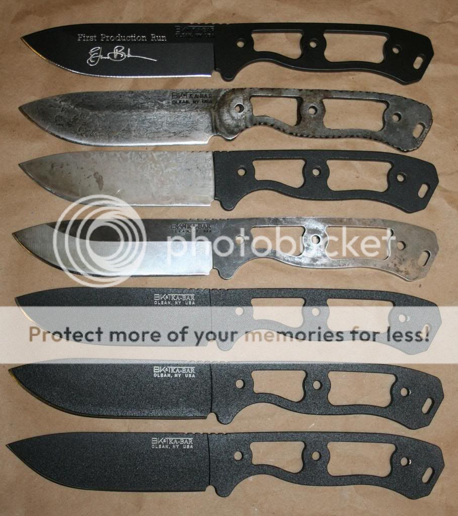

Here are all of my BK-16's except 1. The top 4 are pretty consistent and I am very happy with the blade shape and original factory grinds. I have convexed number 2 and 3.

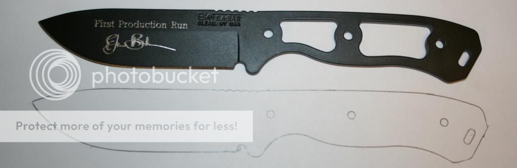

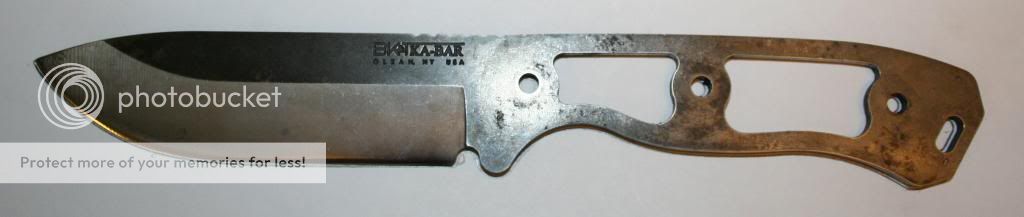

Here is my best example of what the blade shape should be. The top 4 knives were really close to this one. I traced the blade to compare all the other blades to it.

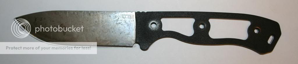

My User Full Flat grind. Same blade shape just a hair smaller which is fine and could be due to the convexing. The other two BK-16's I gave away were very close to this one and the grinds were perfect.
Here is my favorite BK-16. It's a new coating saber grind. (Please don't ask me how to get one, cause if I knew how to get another I would be buying it right now.)
This one's shape was perfect and was the sharpest Ka-bar I ever received. The shape was actually slightly larger than the other ones but not by much.

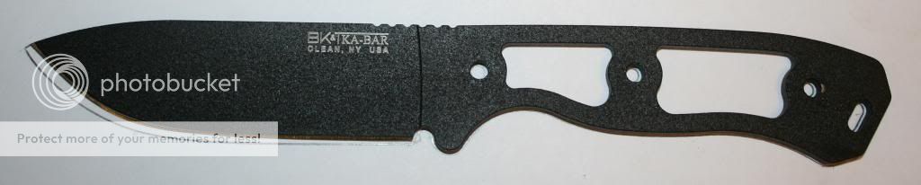

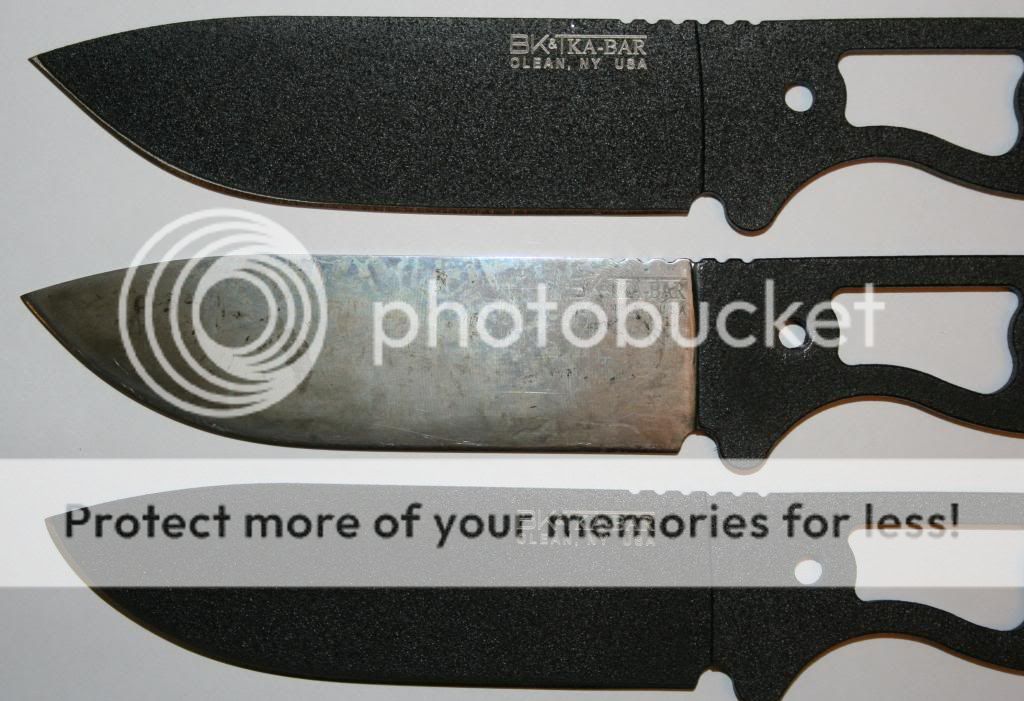

This one is actually not to bad. I could live with it for sure. The real problem is the grind is way over to one side. I could fix it myself.

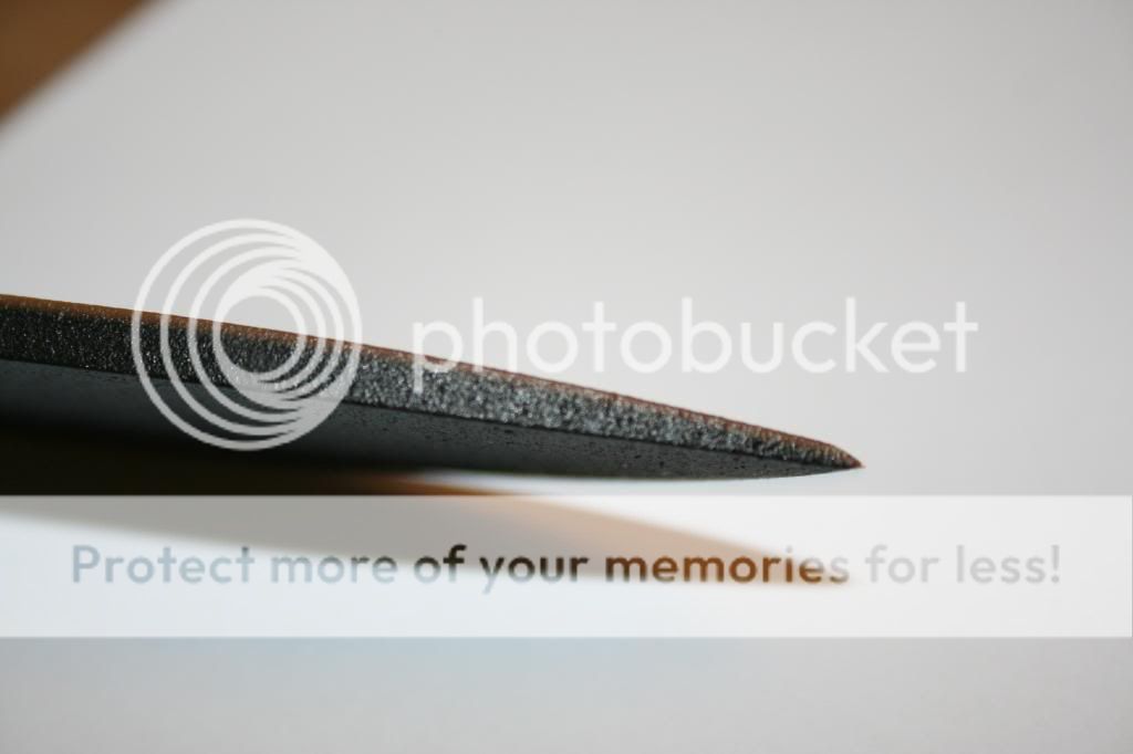

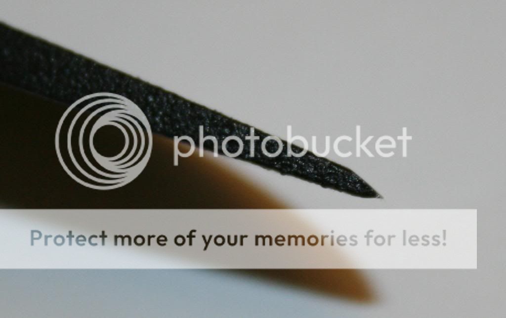

Here is a couple pics of the uneven grind on the tip.

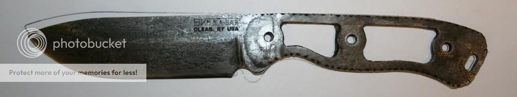

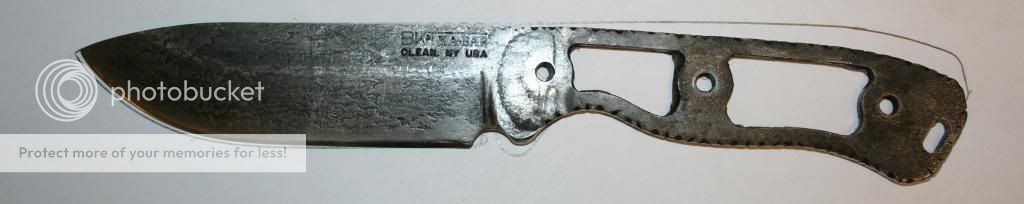

Now this guy is just ridiculous. See that big flat spot where it should be curved?
And this one is even worse. Looks like a stubby 16.

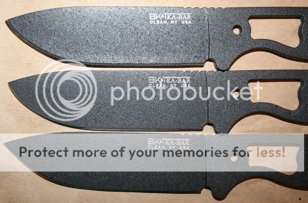

All three bad one's together.
The worst two next to my good one.

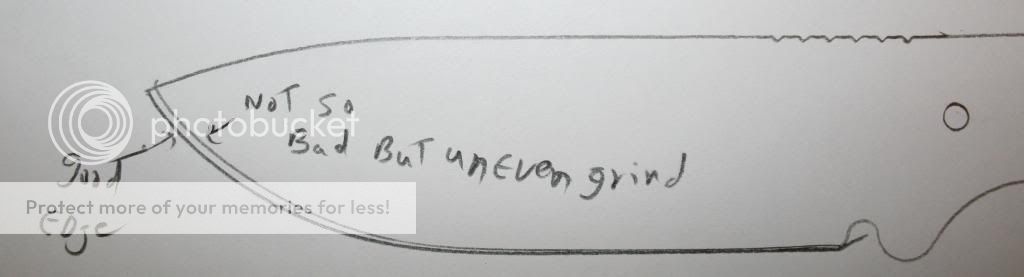

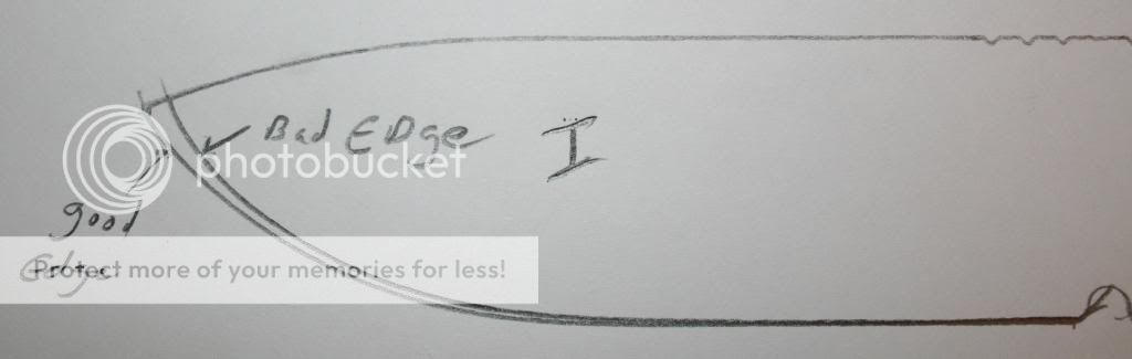

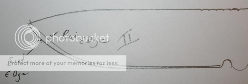

Some tracings of the three bad blades next to a good blade.
Hope the pictures show what I was talking about. I tried to keep everything as consistent as possible while photographing.

Sure looks like a new person at the grinder/sander...Now is when QC can shine...tracing the knives back to who made them, carefully inspecting what he/she is currently working on and retraining as needed.
The bent ones looks like seconds to me that possibly slid through the QC process as not the one in ten being inspected.
