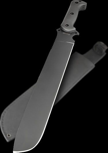

In the general section I asked if anybody had any experience with the KA-BAR Grass Machete. It was suggested that I come here and try for info.
I was wondering how thick it is.
It's got a funky looking grind, can someone explain why so?
Blade thickness is .165", Tsujimoto Style handle (good), and a multiground edge.
From what I have heard, the added bevels are there to help put air between the blade and a wetter media, say, tall green grass when its swung.
Think potato slices on a flat ground chef's knife, without the scallops. It sticks. With the multi bevel, it limits the stick, and the wider angle at less linear distance from the edge, force the media at a more outward angle.
So, imagine our self swinging this thing through wet grass, and the grass flying away from the blade after the cut, instead of it folding over and foiling your backswing.
That's what I heard, multi bevels are not really a new concept, and some folks will consider it a leg up on making a good convexed edge. That's really the basic premise, is a basic convexing principle, of using the edge to seperate the media, and the blade to seperate it further and faster.

So it's just over 4mm thick?
That's a sturdy grass machete!

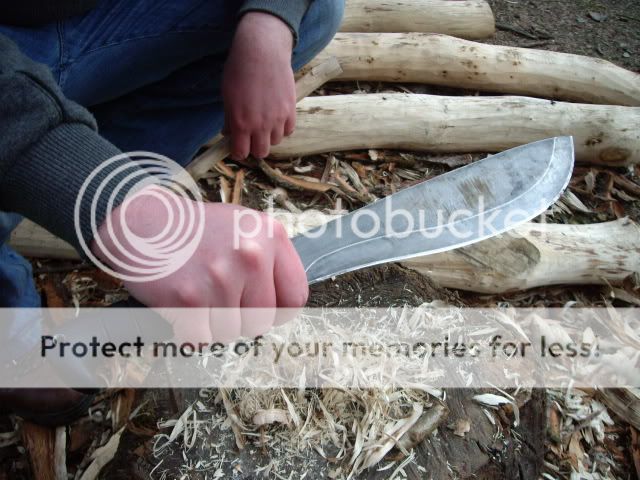

I owned the KA-BAR Cutlass (I think it was the same thickness?) and I was very impressed.
I found it to have great bite and power, the handle was comfy and took the shock out of impacts. For the money it was excellent and I would recommend it to anyone. I'd love to see it tested against more expensive and famous choppers. I gave mine to my sister and she uses it quite a bit now.

Yeah, standard Tsujimoto handle. Kraton, and so far, I haven't gotten hotspots from any Kraton handle, just micarta. Actually, blisters from micarta, not just hotspots. The Kraton is of a softer nature on the Toooj Handles. They don't contour as much as the BKT's, but they fill the hand, and are well designed. They feel almost too big, but you got to think , Toooj has small hands, and he likes them.
The Grass Machete is machete length, but knife thickness. Its a workhorse of a different breed, for sure.

All,
The blade thickness is 0.165" (4.45mm for you metricheads). The grind is what we call a duplex grind. It allows the blade to keep some swing weight but still lets the edge get sharp. This is a problematic edge issue with machete type knives. How do you keep sufficient swing weight and still keep the edge geometry usable. Alot of Machetes have very trucated sabre grinds that don't really work well. KA-BAR wanted something a little better. South/Central American Machetes are mainly used for chopping through leafy vegatation not batoning or chopping hardwoods as is the case in North America. We are suggesting the Grass Machete should be more leafy vegetation and less for hardwoods.
