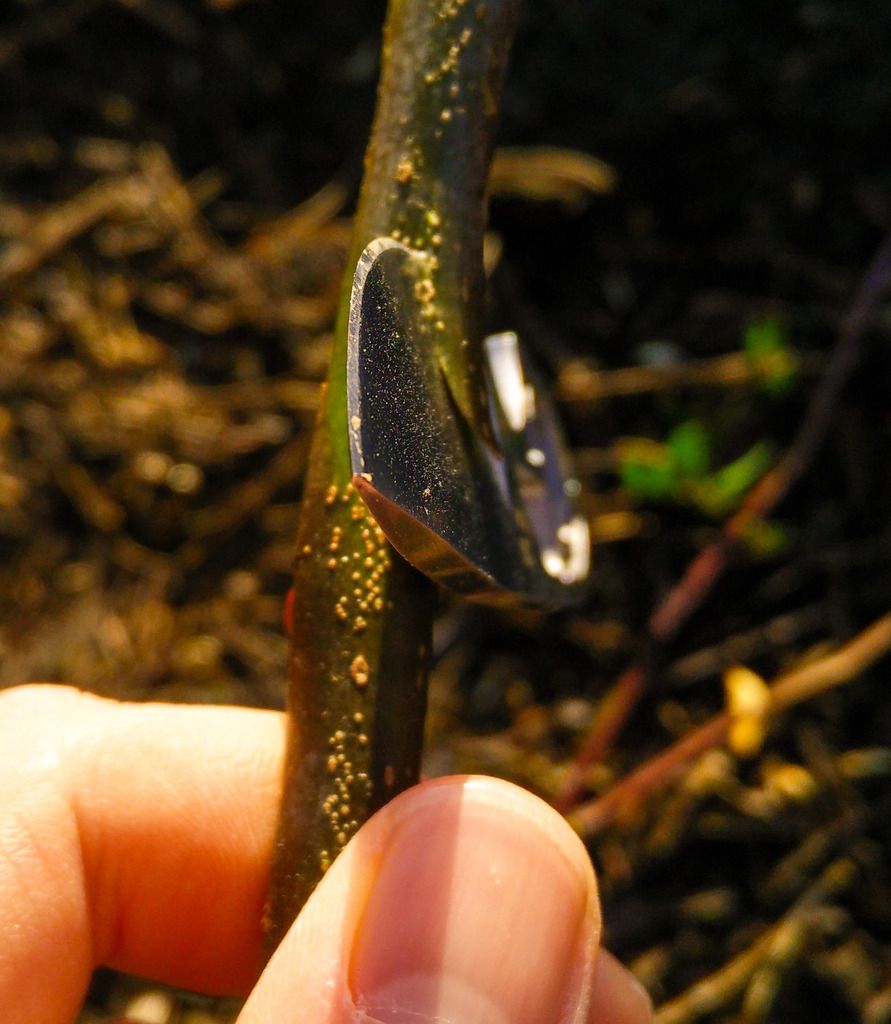

1) The Acheron. Do not like it. At all. As I said, it feels awkward, the curved edge and especially the VERY short hollow grind. Nope, nope, nope.
It's weird that the Piggyback with quite a similar handle profile feels so much better. You do get a little bit more reach, as can be seen in this blurry pic (couldn't get it to focus)... But it's mainly the blade shape combined with the handle though. Big no on the Acheron.
It kinda looks OK, but gets stuck pretty much right away in the wood.
See? Virtually no penetration because you almost immediately hit the "flat" higher up on the grind.

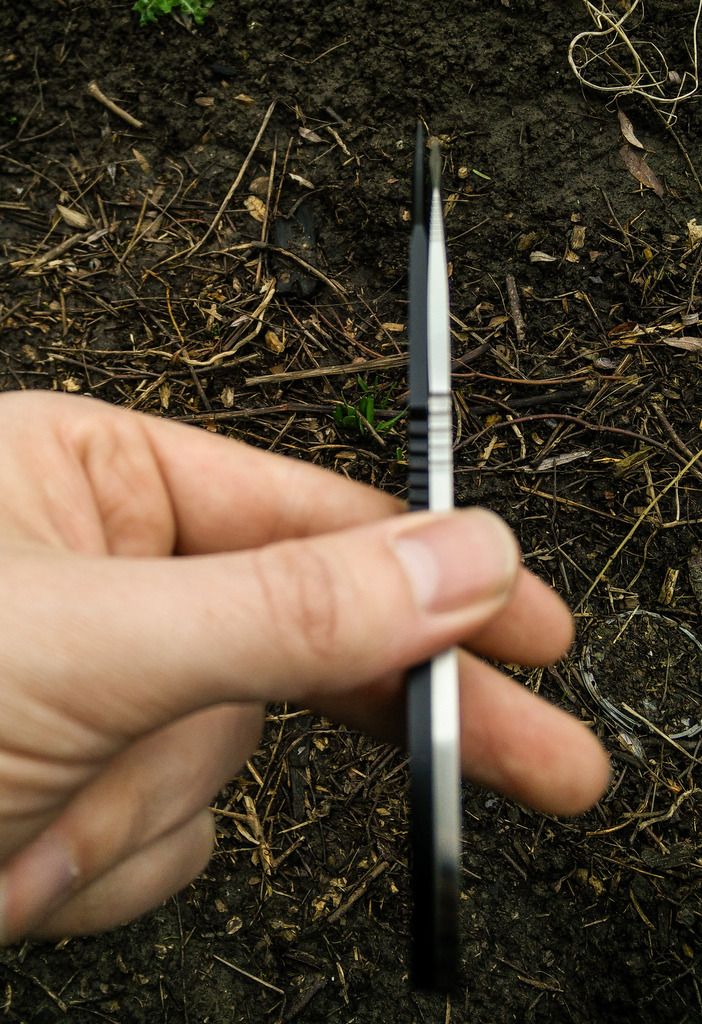

2) Piggyback: MUCH better. I actually like this design a lot. The comfortable jimping near the tip is an ideal resting place if you want to do some push cuts using the thumb of your non-knife hand. Your hand also follows the lines of this blade very well. I like the way this is thought out. This one also cuts WAY deeper into the wood because the hollow grind is a lot higher (pretty much like double the length of the hollow grind on the Acheron). Me likey.

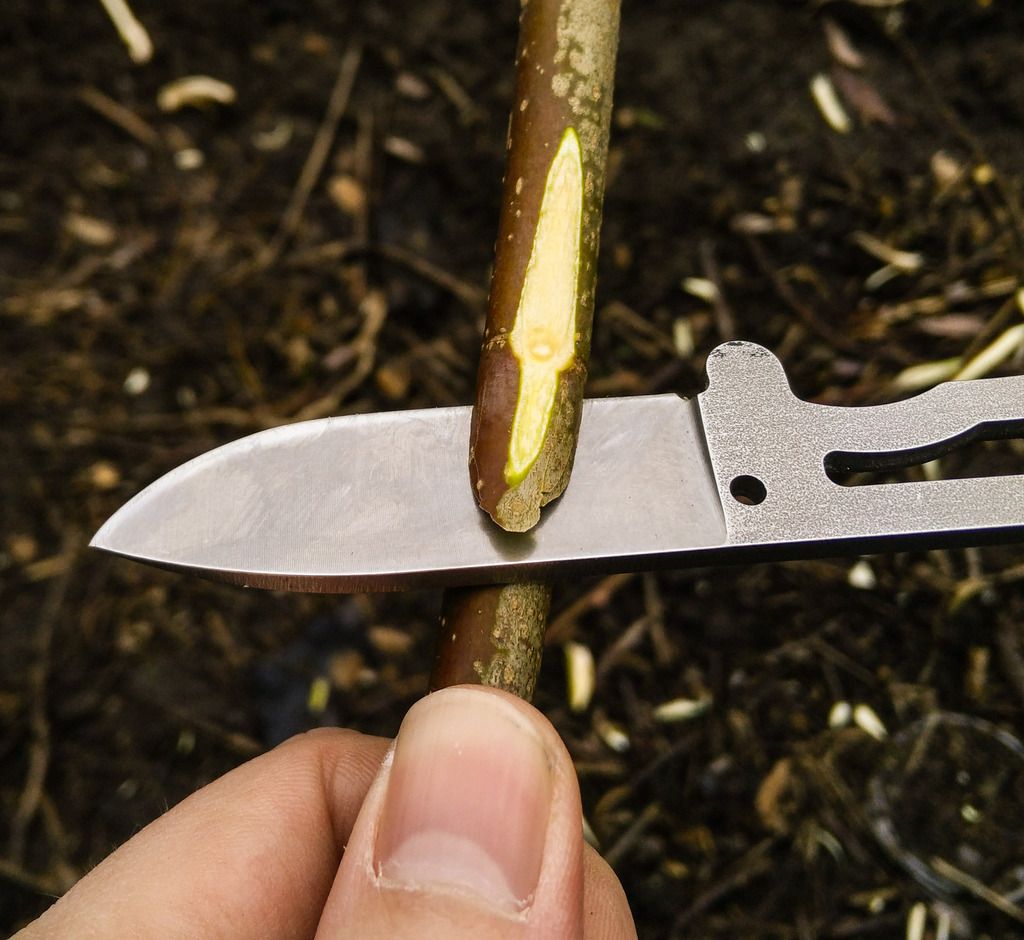

3) The Ka-bar. Nothing special. Doesn't bite as deep as the Piggyback (or the Dozier or the BK13). But it's OK. Seems like the grind is not as hollow as on the others? Not really sure, maybe it's my perception due to the coating. The extra reach given by the handle is a big plus though. It fills out your hand a bit more, gives more stability. I'm guessing this one will do very well in cutting veggies.
4) The Dozier. Bites deep. Good handle length. I really like it. No frills on this one (like jimping), yet a very clean blade instead. It's got quite a bit of good things going for it. I'm impressed, for the price you get a very sturdy piece of steel with good cutting abilities.

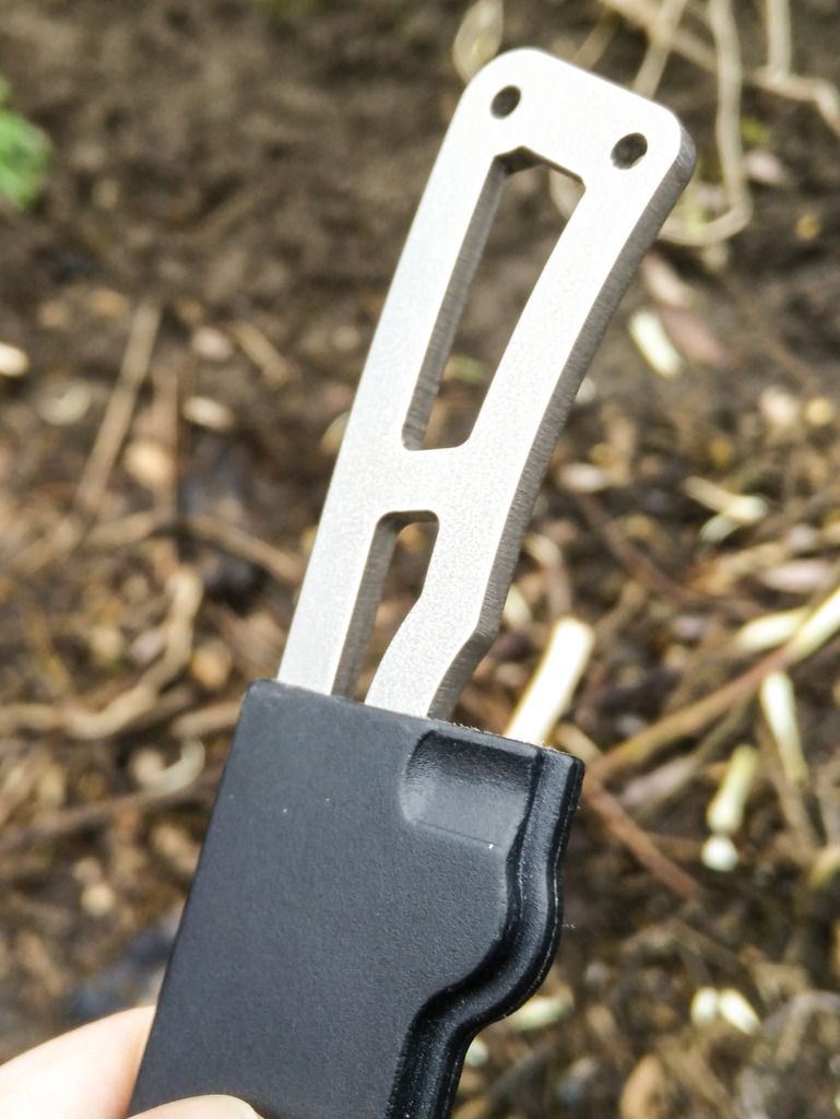

I prefer the folding version though. Mostly because of the steel, but also because of the smaller package AND because of this...
That thing is definitely in the way of my index finger. It's too small to be a guard of sorts, so I think it's merely there to hold the knife in the sheath. I might as well grind it off at some point, since it's quite annoying.

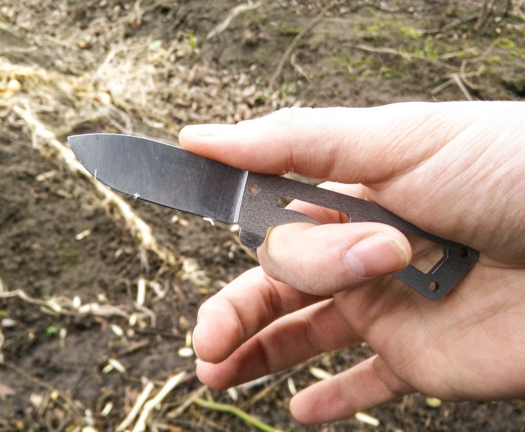

5) The BK13... Really guys, this thing cuts SO MUCH above its weight, it's very impressive. Sharpest of the bunch (maybe 'cause the others still have the factory edge), VERY good and quite deep penetration in the wood too. I was afraid in pairing this one up against some of the larger ones of this bunch o' knives because of the limited handle length. I thought handling comfort would be compromised. Was I wrong...
This is what I mean. You've got enough on your thumb, index, and the palm of your hand to do pretty much all of your cutting. Not a single finger will feel "lost", if you understand what I'm trying to say here. The resting palce for your index is just large enough (for me), and you have plenty of stability and control 'cause it rests in the palm of your hand:
