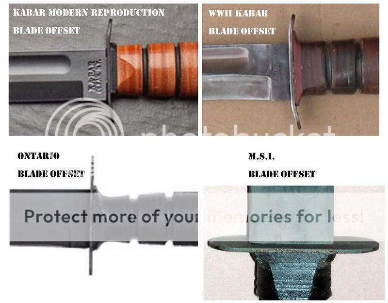

Observe the differences in WW2, post WW2 contract knives and the modern Kabar reproduction. There is a big difference visually:
It looks like the biggest difference between the modern reproduction, and the WW2 version, is the leather washer at the top of the handle.

flatgrinder - I asked this exact question a couple years ago. We have dozens of antique shops here in our area, and I've seen and handled at least one example from each mfr. of every WWII contract F/U made.* The handle alignment differences are pretty obvious up close, but at a distance, they all look like the good ol' Kabar. My OCD was really twitching after seeing the differences in the handles.
One shop owner told me he gets asked the Kabar handle alignment question occasionally and couldn't answer it. I emailed him the link to the "tech talk" thread after toooj explained it. Apparently it had to do with finger clearance. To me it makes sense: I cooked professionally for a while, and that's the way a lot of kitchen knives are designed. The handle sits higher for clearance underneath.
Here's the "tech talk" thread. I asked the question in post #697, and toooj answered in post #700.
http://www.bladeforums.com/forums/showthread.php/872443-Tech-Talk-With-Toooj?p=12184374#post12184374
~Chris
*I've also gotten to compare the Cattaraugus 225Q, the Case 337-6Q, and the Ontario version as well. For war-era knives, the F/U's and Quartermaster knives all got the job done, and did it well. I'd be happy to take any of them into a war zone if I had to.

I think the blade offset is there to strengthen the blade. The tang is so tiny that it really helps with stresses to have the tang not perfectly in line with the blade. I can see how it would improve strength. It is just my opinion and thoughts on this: I think that the tang was made so slim and tiny to save some steel.. This might be completely untrue and irrelevant.. I have no idea why anyone would design a knife with a slim tang like that for any other reason...The Camillus Quartermaster 225Q had a THICK tang, so who knows why the Mark II was designed so spinelessly in comparison... Both Camillus and Kabar both were contracted to make the 1219C2 in WWII and both used the same design... That is why I think that the 1219C2 was designed that way in the first place. If you can save some metal on some tangs and still have the knife work that might be a jeep or tank eventually... Who knows, honestly if the designers of the 1219C2 specified the tang to be so narrow for any other reason, they must have been smoking something else in their pipes... IMHO. Still tried and true with failures like this.. Usually from abuse.
I have no idea why Kabar doesn't make a 1217 with a tang like Camillus's Quartermaster 225Q. I love the new EK model 3's that just came out with what looks a lot like BM CO/Victory Plastics NORD Govt' sheaths of the original EK period. Good work on that one. Kudos to Kabar for that.. That would still be one hell of a knife though.. - Cold Steel made a version of the 1217 called the "Leather Neck" just like that. I would like to see Kabar make a M II knife with twice the tang on it for more money than the normal 1217's... I would rather buy a Kabar than CS's version personally.
