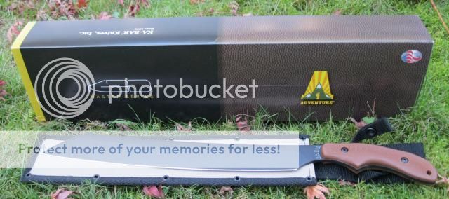

Well big brown showed up last night so I figured I'd better get pictures posted.

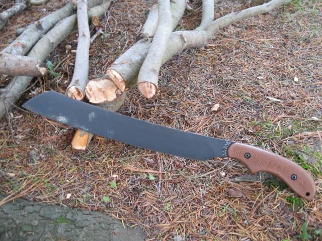

First I want to tip my hat to Steve Johnson. His Parangatang machete makes a very positive impression the minute you heft it. My biggest challenge was waiting for daylight to at least get one picture of it before I broke it in. This is a really nice piece of gear.

Thanks again to the folks at KA-BAR. I'm thinking this Parangatang is going to end up selling you some more as I let my friends use it. Mind you they aren't going to be allowed to borrow it.

I've always been predisposed towards axes growing up in Michigan. Really didn't start using machetes much before the last 20 years. I've never spent more than $30 for one as I thought they had what was necessary to do the job. The Parangatang shows me that there is a difference. While others results may vary, I see myself adjusting my various kits in the future to include this piece of gear.
