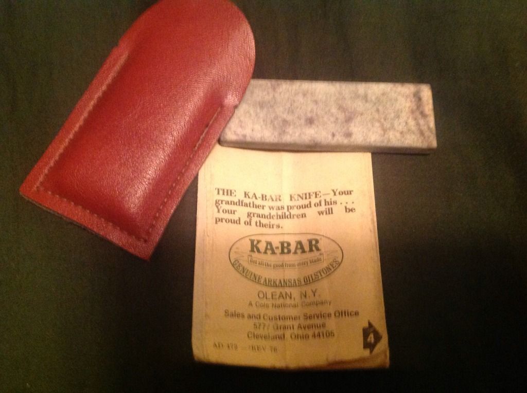

Thanks Gunsil! That would put my knife in the '23-'24 time period then since those were the only years that had the guard stamp but not the patent stamp... actually if it was Jan of 24' then it was likely made in 23' perhaps this was the only year with this stamp combination? At any rate you got it within a couple years and that is pretty darn good! That's better than I could have hoped for. I certainly hope you and your friend publish your findings. I'd be one of the first in line to get a copy! It would be an extremely valuable resource for KA-BAR collectors everywhere. If I ever come across anything that might help your research I'll certainly send it your way... The only thing I've seen that was remotely informative was a post on this forum earlier this year http://www.bladeforums.com/forums/s...-Company-A-little-Kabar-history-(zoom-needed) I found the picture of the buried knives to be quite interesting. Looking back at this reminded me of another piece of KA-BAR that I have... also from my grandfather... It's an Arkansas Oilstone that was in his hunting bag. I still even use it occasionally. It is still in the pouch and has the paper fold out tucked inside as well. I didn't even notice what it said on the back until I was just looking it over... but it sure is fitting. It says:"THE KA-BAR KNIFE- Your grandfather was proud of his... Your grandchildren will be proud of theirs."
