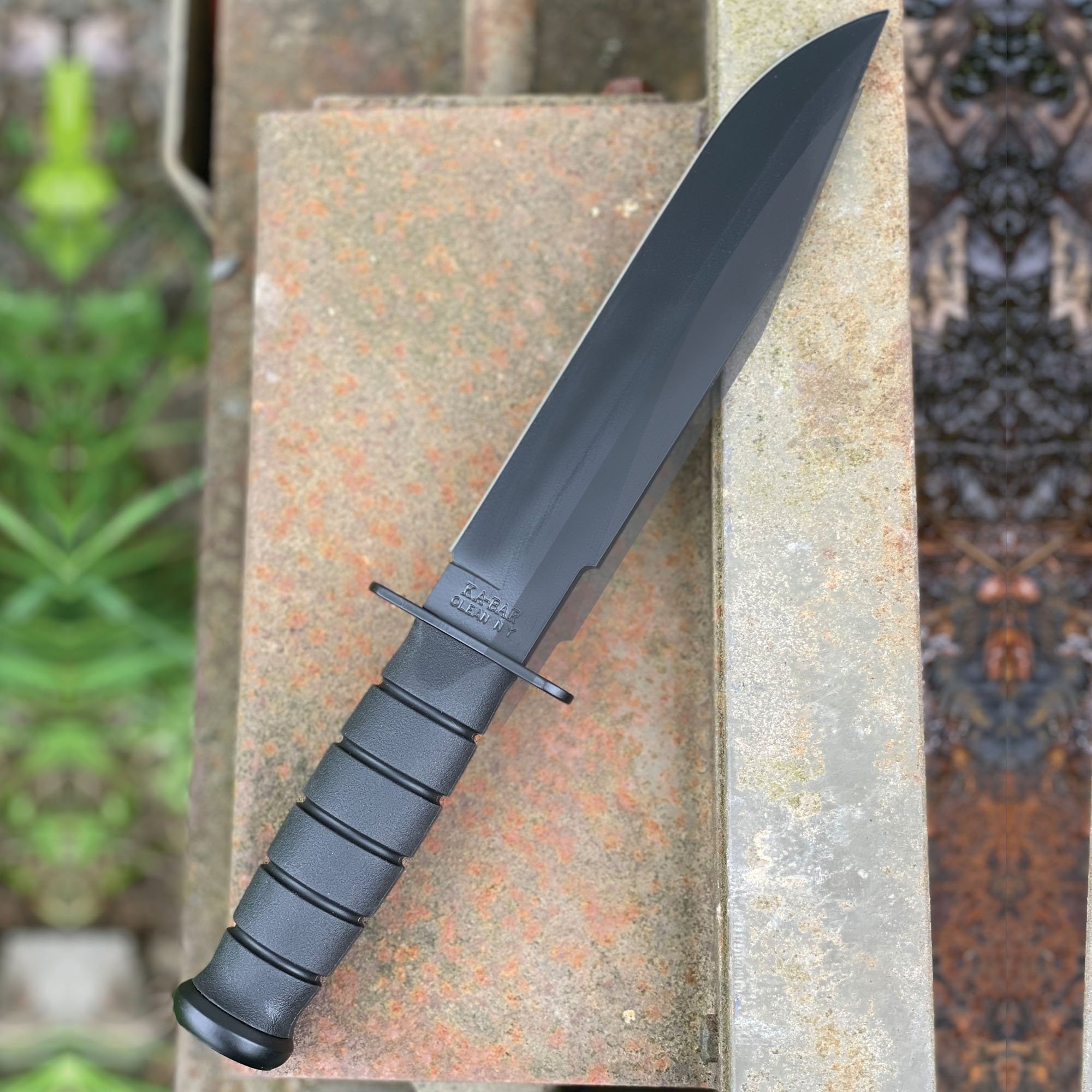

Fella I know is after a decent knife. His use is some field work, camping use, also pig sticking with dogs. Currently uses a cheap boning knife of all things. He wanted something a bit more serious but not overkill, 7" blade as that works on even the larger hogs. I suggested the kabar-Im ex military myself but not from the US, the knife however is pretty well known to us. I have on ontario which is no longer stocked here. Frankly not being a knife guy I dont know a lot of other options and figured the kabar is a safe bet. How does it look these days to you advanced blade guys though? Metals, construction, fittings still considered respectable? Am I missing anything?
Edited to add, as I am getting a few recommendations for heavier bowies, esee and beckers etc. For pig sticking some degree of slimness is good, also needs a handguard to stop riding onto the blade when things are bloody. I had a look at the beckers and Esees and I dont think any are real great in these regards.

The iconic USMC fighting knife or Ka-Bar, has a nice profile and has worked well for 80 years and more. Today, it will do as well with the tasks described as it would have done in 1945. However, the original spec is for carbon steel and leather handle. There are now better materials available. Ka-Bar offers a modernized knife of the same form with a D-2 blade and synthetic handle. Some on this forum have a less favorable view of D-2.
There may be "better" knives for the tasks described. Equivalent in length and form, but with modern alloys and materials. One question might be, "How much better does it need to be?" In part, it may come down to knowing how much your friend wishes to spend.

The Ka-Bar is good to go for hog hunting. If you took the time to sharpen the swedge it would be even better.
As touched upon earlier by sgt1372 sgt1372 , the kraton version will be a bit more impervious to the elements, and the sheath will be more secure.
I have used the leather stacked handle for hunting hogs, and it works fine.
A couple of things to think about:
The polymer sheath offered with the kraton version will retain the knife better than the leather sheath. I have lost a Ka-Bar by it falling out. The kraton will be noisier though, but this is not an issue when dog-hunting. If you are stalking pigs, then it will.
The leather handle rings will need a copious amount of leather treatment. After washing a few times, the leather rings will shrink up and cause the guard to loosen. The treatment will help alleviate that.
I prefer the guard on the Dog's Head model, but it comes with the leather sheath. I have learned to use Ranger bands to keep the knife from falling out.
